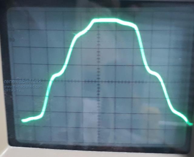

Sine wave looks fantastic with fridge, compressor, blow heater, elec oven, toaster, any of those and it's fine.

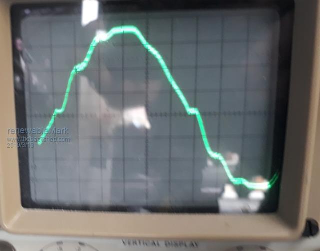

BUT, hair dryer on low it turns to crap, this has been talked about previously as a known cause for crap wave as it chops half the power with a diode.
AND Air con on low settings.
It's a very late model inverter AC unit, on full power sine is fine, but low fan settings it turns to crap, it varies in it's level of crap.
Below are AC on low fan speed.

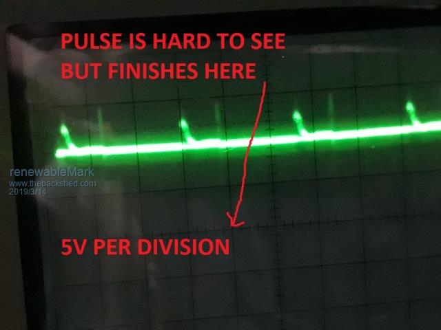

On arriving home today the radio was giving me that terrible EMI again, so an effort was made to find it.
Turned out to be the Mad pwm controller.
Then the inverter DC terminals got tested while this emi was being produced.
This isn't the battery but the terminals that connect to the power board.
There is a stronger pulse and a lighter one which is hard to see on camera but very clear to the eye.
Would that be a concern?

I was previously able to start and stop it as many times as desired, now it just wants to be totally random.
Cheers Caveman Mark
Off grid eastern Melb
Posted: 09:05am 14 Mar 2019
  renewableMark said
Then fit caps, start it up and BANG!
So, has all that soldering and unsoldering damaged the caps? Test them individually on your battery bank (not inside the inverter) via a slow charge resistor. Just a guess though.
When something runs satisfactorily for some time and you then do some modifications, causing it to go 'bang' then you need to analyze *each* step that you took to see where the gremlins could have got in.
It could be something silly like a solder blob in the wrong place or something replaced the wrong way round .

Nup, that was a brand new set. Got more spares than RS components here (except for 4008's).
Don't understand why it ran fine on resistance power then ok for a while with caps fitted then a random BANG when restarted. There was no error from previous either, it was just a plain shut down with on off switch. Upon cap charge and turn on it just went bang. No reason, makes me sus of the 8010.
Cheers Caveman Mark
