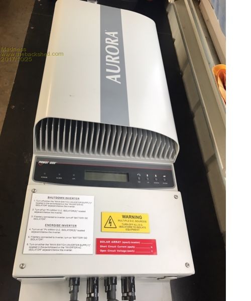

Bought this Aurora 5KW GTI today for not much money, has RISO LOW Error. After googling the error before buying it found lots of search results where it is a ground fault in the PV array or cables. It will not operate with less than 1 Megaohm to ground. However when I got it home and tried it the reading on the display is 0.00 M ohms. I removed the MOV's which a couple of them showed 0.3 M ohm, but without them installed still shows 0.00.
Has anyone else had on of these do the same?

you could hook it through a galvanically isolated transformer and it should run if the inverter itself is not faulty.
if the megohm meter is not reading anything it seems to suggest it is badly leaking to earth inside the inverter or the meter is not working. I have sent a couple of out of warranty ABB inverters back for repairs for a different fault, it cost about $300 to get them fixed by the company but that is a couple of years ago, things might have changed.
I think the inverters earth strap has to be installed before the complete DC circuit can be tested for leakage with a megger. maybe there is a poor earth to that board.Edited by yahoo2 2017-10-26

I have only had a very quick look at it so far, I think the fault is somewhere past the DC input relays.
I was testing with it connected to the grid with earth connected, I am very wary of connecting GTI's to my off grid inverter after the recent episode I had that killed several PCB's.

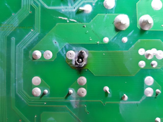

Update
Got the PCB out, there is a burnt connection on an AC relay, I repaired this but still no improvement looks like it might be going in the too hard basket.
Edited by Madness 2017-10-27

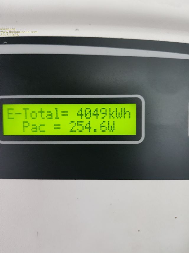

Well I just had a win, the IGBTs for the Zeversolar arrived. Put them in and turned it on connected the grid, no bangs just a faint click of the relay and back in business. I did check everything around them including the 3120 driver chips but everything else was all the same measurements on every set of drivers.
Connected it to my inverter via a 20A breaker and alls well. Perhaps there may have been something wrong with it from day one that I got it. Before it would trip a 20A breaker on connection every time, that was why I had a 63A on it.
Although the Aerosharp worked for me when it got to full power it squealed like a stuck pig, it had me ducking for cover with my shell shock. Edited by Madness 2017-10-27
