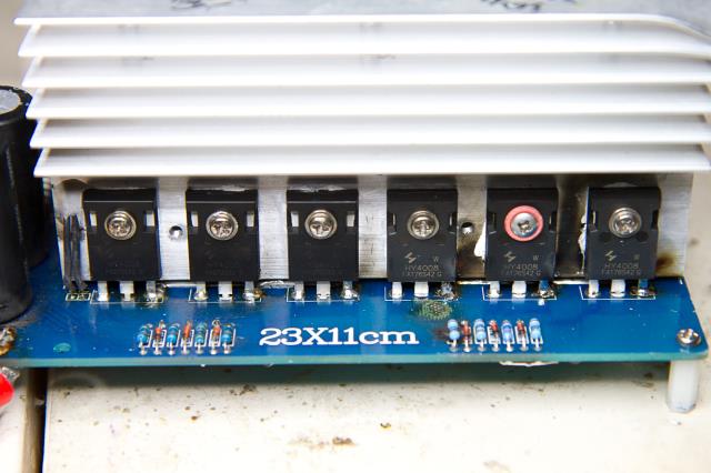

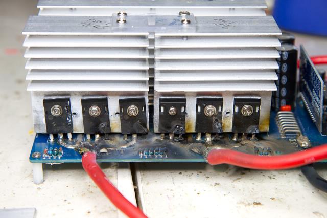

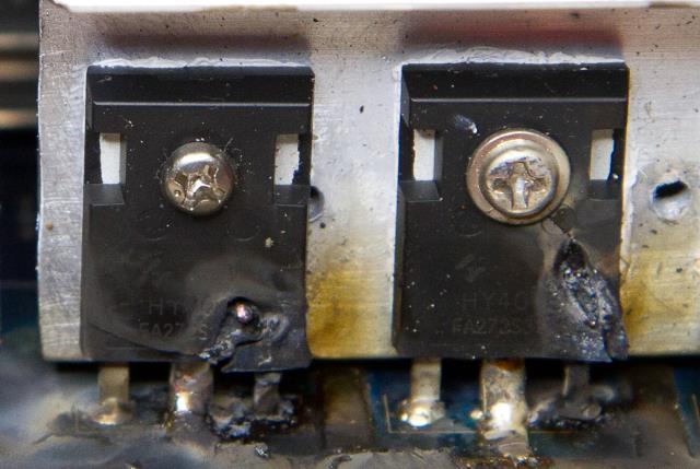

Mad, here are the results of the 'splosion.
High side FETS
Low side FETS.

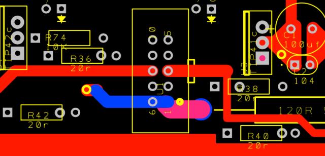

Anyway, I just got my spare Mad power board assembled and tested.
It did not work! Lucky I only had one capacitor installed, else
we'd have more photos of destruction.
The reason it did not work was due to a redundant component lead hole
that is near R36.
See R36? There is one hole for a lead on the left and there are 2 holes for a lead on the right. I fit the 20R resistor using the closest holes, that is, the inner hole on the right. This is a trap for the unwary.
As it happens this is not the only component where there are these unneeded and confusing extra holes.
To anybody building one of Madness's larger power boards, look carefully at these
footprints and pin holes for all 4 of the 20R resistors. Make sure you have a clear understanding of which pins need to be soldered and which are to be left unused.
It could so easily have blown all 12 FETS, certainly blown 6 if I had fitted any more capacitance.
Anyway, once I refit R36 properly, it lives!

That's a "PROPER JOB" on those FETs, well done
Those extra holes in the PCB are there if you wanted to bypass the totem poles. By putting a link in the two closest holes and another across the tip41 and tip42 emitters the gate drive is direct.
It's a left over from the early days when I was trying to figure out why I was blowing up so many MOSFETs. If I get any more made it will be eliminated.

Yes, the tiny 2 internal source wires got overloaded and caused meltdown. I had exactly the same looking mosfet faces when testing how much they can stand

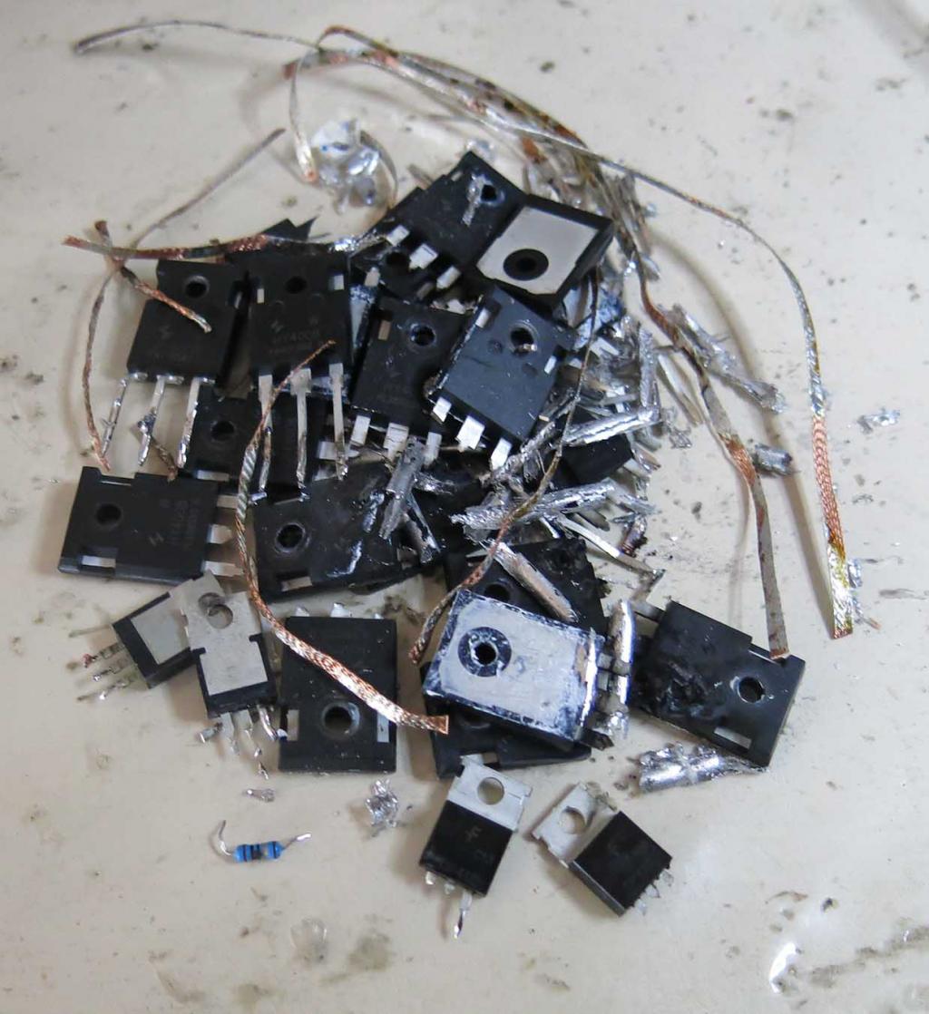

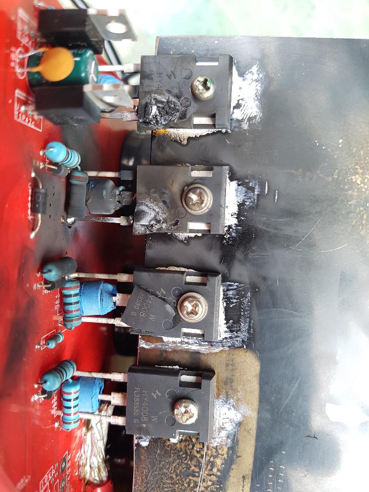

Yesterday the power board blew. All top side FETS clearly gorn.
I discovered eventually during the board repair process that
all FETS were stuffed, the two high side totem pole drive's transistors were blown, and one of the 20 ohm gate drive resistors was about 40K ohms and had become a capacitor too.
the results after removal
Repair did not go smoothly, even though the PCB was not damaged at all due to the whoopsie.
After setting up a test with one FET in each leg, I had the chance to capture on video a lovely example showing why nobody should ever hire me as an electronics trouble shooter.
first power up attempt
After that, I eventually found that all 4 TIP4x transistors were blown and the 20R gate drive current source for one of the high sides.
But now all is well and time to see what is causing this inverter to die after a week. This time death occurred when driving a 500W load.
