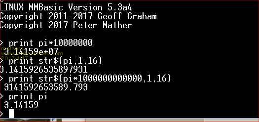

Posted: 04:28am 17 Apr 2017
New minor update 5.3a4. This has the floating point formatting re-written and will now output as many significant digits as required.
2017-04-17_142750_mmbasic.zip
