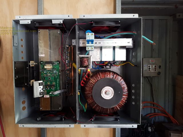

The Inverter is now on the wall, I figured it will be far easier to assemble it from here that way as there is no way I could lift it when finished.
The major parts are now in place, top right is 3 filters from output of Aero-sharps. There is a perspex panel to go on the top left that will have screen and buttons for Arduino based monitoring system I am working on as well. It will control fans as well as data logging temperatures, current and voltages, this will be accessible via ethernet and display current information on a 3.5" TFT LCD with touch screen.

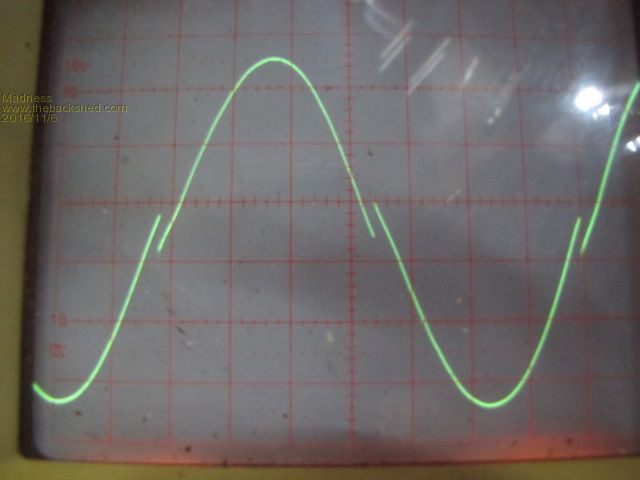

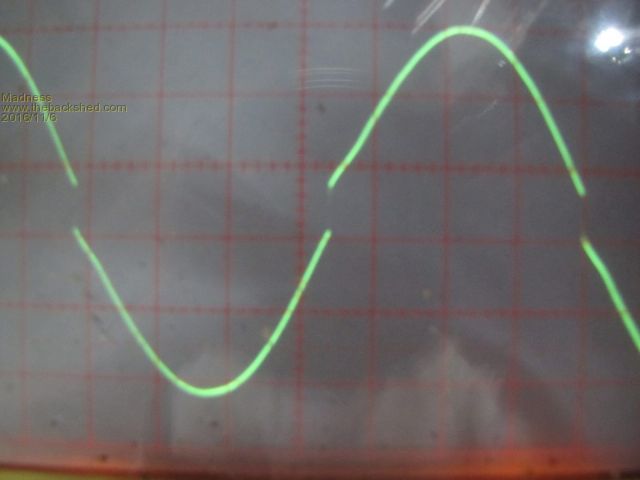

Big problem I have though is bad wave-form as shown below, something wrong the timing, have tried 3 different power board layouts, get the same result with all of them.I am going to try ordering components locally for the control board to see if that rectifies this. Images are with no load, adding up to 2.4 makes the wave blurred and lots os of squiggles in it, the toroid and choke make lots of horrible noises when this happens also.
These are from the the 2 sides of the secondary output.

Mad you have made some progress, you have discovered that the waveforms and power dissipation seem ok when just 4 fets are in the H Bridge, then get worse when fully populated.
If you are using the IRFB4110 fets then each has a gate cap of 9620pf multiplied by the number of fets in cct, perhaps your driver chips are running out of grunt to switch the mosfets cleanly when more are populated, or there is a higher resistance or bad connection in the ribbon cable between the control and power board.
I would put your scope probe between 0v and each of the mosfet gates to check that the gate drive signals are clean sharp steep sided transitions with no oscillations. Perhaps swap out the driver chips, one may be damaged from previous issues.
Personally I dont like using ribbon cables for these sort of drive circuits, short duration high current pulses are required switching the gates, ribbon cable and associated crimp connections isnt exactly the ideal here, preferably use twisted pairs of thicker wire for each the gate drives.

Yes making progress, 3 steps forward and 2 steps back but it is progress.
I am using IRFP4110 which is TO247 version of the IRFB4110, as far as I am aware it the same silicon in a heavier case and much more substantial legs. Capacitance is identical, also these FETS end up with very short legs with just 4mm between the case and PCB. Wether this lower resistance here is a factor I don't know, power boards using the TO220 version would have at least 10mm of much skinnier legs
As OZ has it working without any of these issues I am scratching my head, I will replace the ribbon cable with some heavier wire with ground wire twisted on each gate drive and try it.
I have looked at FET gates with the scope and everything looked clean and identical to the output of the of the IR2110's. I will be looking closely at it as I build the new PCB adding 4 FETs at a time and testing at each stage.
Also, I am planning to test each FET individually with power on it and check them as per this video and group them. This will also help to eliminate any that may be faulty.

Madness, perhaps I found a clue to your sine wave distortion problem.
Did you try to run the inverter without that big ferrite choke in the primary circuit?
I saw that my small test inverter had a badly distorted 240V wave form when I used a ferrite choke I had just quickly wound for my testing. No distortion with no choke at all nor with my big 60mm sq wire one.

Thanks for the input, I actually have a very nice clean Sine Wave now thanks to your tip regarding connecting the CRO.
However still getting exploding FETs, had 4 FETs on the PCB today, ran it up to 2.2 KW for about 5 minutes running a fan heater, there was just a very tiny distortion at Zero crossing, similar to OZtules early results. Then I turned the heat off and just left the fan running, after about 45 minutes BANG. I need a blast shield for this #%^!@& thing. It ran perfectly for that 45 minutes, just a little buzz in the transformer, which I get in all 3 different transformers I have been using.
Postmortem I found 1 Fet with a large crater, 1 with a big crack and other 2 shorted to the gate. Chinese IF2110 that makes the SPWM was also dead.
I have replaced the 2 IF2110's with genuine ones I had on hand and replaced the FETs. I have had it running for about 30 minutes with 1200w load on 4 FETs since repairing it. Now going to try with 8 FETs.

Just come back in from another session of working on the Inverter. I now have 8 FETs running perfect sine wave at idle, just the tiniest little blip at zero crossing running a fan heater at 2200 watts(would much rather it was an AC with this stinking hot weather) FETs are rising about 2 degrees above the heatsink after running about 30 minutes and heatsink barely above starting temperature. This is with no fans just got it standing on it's end so it can draw air through naturally.
I found what I think caused the last explosion, the edge of the Kapton tape I put on the heatsink bottom was pinched under the bottom of one of the MOSFETs. It was marked by it, so was definitely keeping it from making good contact.
Tomorrow I will add another 4 and see if it keeps behaving itself.
