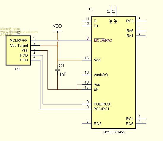

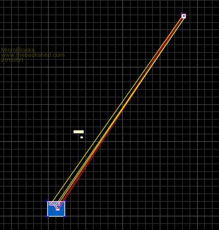

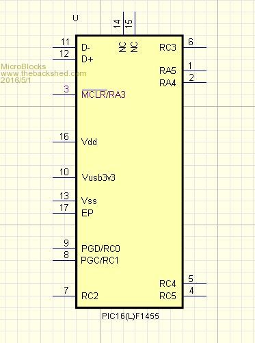

@Mick,
I have EXACTLY the same workflow!

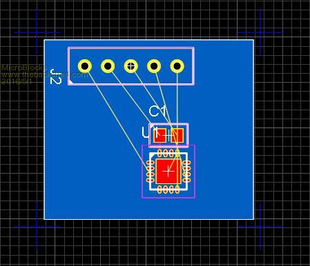

I tried to get to the bottom of the error and i hope i have found it.
I made a part, a PIC16F1455.
Placed it on the schematic with a header, capacitor and a Vcc terminal.
Draw some lines.
Noticed a less optimal placement of a pin. Edited the part.
Then in schematic selected it , then refreshed from library.
At that moment my PCB is basically destroyed.
Even some phantom 'parts' appeared.
The board boundaries are also gone but reappear after a click, so that is not really a big bug, more a UI glitch.
At first i thought it was caused by me accidentally dragging the footprint 'placement point' (WHICH IS AN ABSOLUTE NO NO!!!! What is the point of a library if part footprint is not absolutely locked!) but after discarding everything and start over (for the fifth time) i ruled that out.

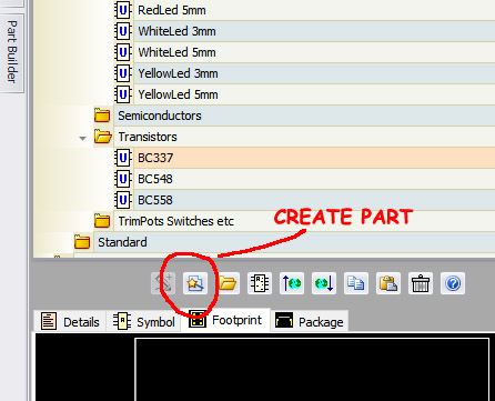

Hi Jean,
I have created many parts and I have not seen the likes of that. I admit I did have a similar situation occur once where I selected show all and the PCB was a tiny little thing in the centre of the screen. It turned out that for some reason I had a Component text appear miles away from the component.. It only occurred to me the once many months ago..

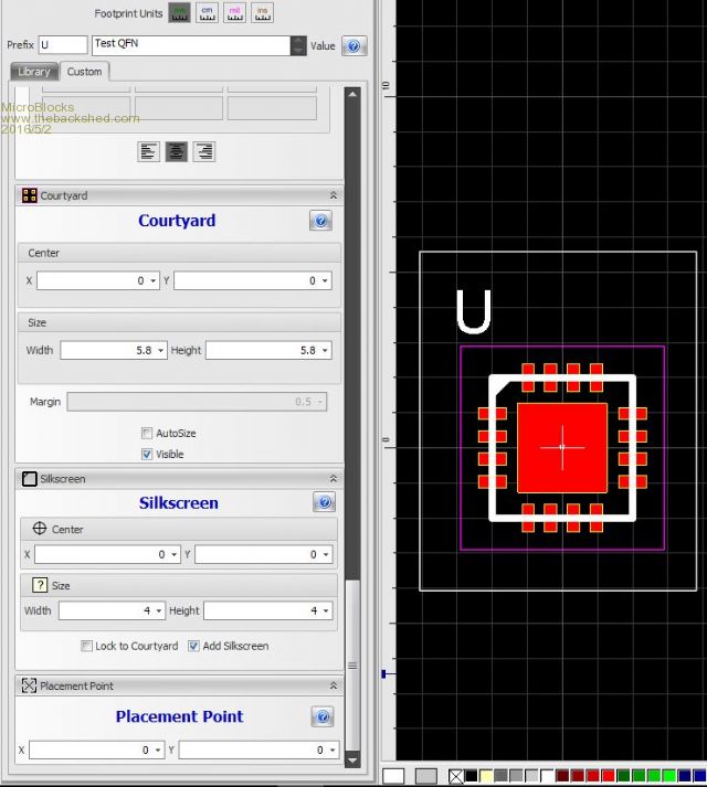

When you created your part did you use the part creator?
See this image in the LIBRARY tab.
It loads a part creation wizard and I have never sen it do what you have shown there.

Mick, yes i use the part builder.
made a QFN by changing a few parameters. (That part is great timesaver).
Little bit bummed that i do not get it to work.
Thrown out the part, deinstalled dex, erased all directories and installed everything fresh.
Maybe i have done something that got stuck.

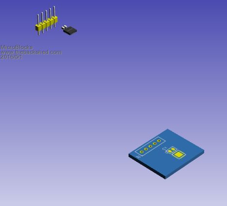

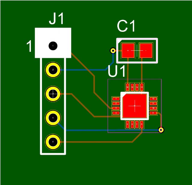

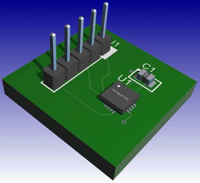

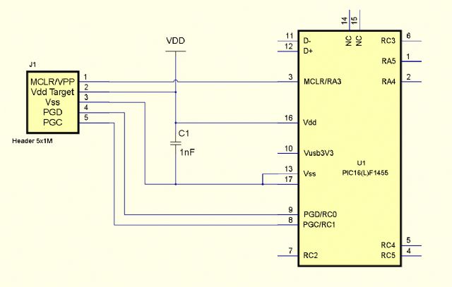

Hi MicroBlocks,
I tried your demo from scratch and didn't have any issue like you experienced.
Here is my interpretation of what you tried to do.
I created the part from scratch using the Part editor (one Issue I will mention at the end of this message)
2016-05-02_013725_PIC16LF1455.zip
Then I drew the schematic with a 1nf cap (0805 footprint) with a 5x1 Male header (one of my earlier parts in my libraries)
Then I Re-sized the PCB to be of a suitable size for the parts and routed with electra.
I changed 1 track from the bottom layer to the top to eliminate a via that wasnt necessary (My anal-ness there)
Here is the project file for your interest
/2016-05-02_014113_MicroBlocks.zip">2016-05-02_014113_MicroBlocks.zip
Now I mentioned earlier that there was one issue with part creation (using the part builder wizard)..
After creating the part as a 4 x 4 QFN (yes my image is TQFP as there wasn't a default QFN pack in part builder) I rearranged the image in the schematic to reflect your layout I then realised you had a pin 17 which I gather was the metal tab underneath the Chip itself, so I went to the PCB and added a PAD (#17), and resized the silk screen to clear the pad and resized to 2.5mm square (as per datasheet) then when I went back to the schematic I had it had reverted to the square (ish) shape the part builder created.. Damn that cost me 2 minutes of my life to re-do
I think that is a minor bug that I will report to Iliya but over all I didnt have any issues with your example..

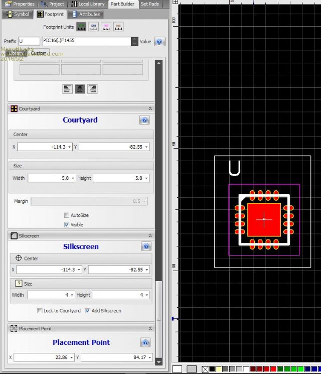

I made the 'QFN' the same as you did. Selected a TQFP and then selected the leadless checkbox under 'Parameters'.
After a night sleep and trying to think what the exact moment was that things went wrong there are two possibilities. One is redefing the Del shortcut which might have strange behavious or (and i suspect this highly now) the update to 8.01.24.
ps. Thanks for trying out and show that it works. Must be something wrong at my side. I have done a reinstall and checked all my drivers.
Edit: I FOUND THE PROBLEM!!
I recreated everything and it works fine now.
Loading the previously made part this is the difference:
Problematic part:
Good part:
Visually they are both exactly the same. However in the parameters the center X and Y coordinates for Prefix, Courtyard,Silkscreen and Placement point are not from the center of the part in the problematic one.
I was also unable to fix the problematic one by changing those values, i had to redraw/generate the part to get the right center.
Now the question is how the #$@ did that happen!

Thank you I do not know why the project file I uploaded didnt work (that is a TBS thing..) Anyway here it is again,
Note it has the TQFP package for 3D instead of the QFN (big deal) but as Jean rightly pointed out a single click under the part builder on "leadless" (i wonder why he didnt chose the term "LEGLESS" ) does the trick.

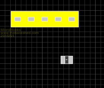

Posted: 07:05pm 01 May 2016
Could not fix it because the numbers for the center did not make sense at all.
All the centers in the correct part are 0,0.
In the problem part they are different while the visual representation is correct, which would suggest that there are two sets of numbers or two sets of 'origins'.
.... some time passes .......
Yep, it is the PCB that is in the 'Part' that has an origin on the left/bottom. The center of the part then changes to a coordinated calculated from that point.
Resetting the center of the PCB in the footprint of the part to 0,0 fixes the problem.
Now the question is, what is a PCB board doing in a library part?
Posts: 2984
Posted: 07:13pm 01 May 2016
@MB,
The PCB is not actually IN the part it is just a representation for the 3D to give some indication of how it would look in a PCB design.
I also noticed you had rounded pads in your original design, was that intentional?
Posted: 07:34pm 01 May 2016
Yes it is IN the part and will act as an origin somehow when you resize it.
You can see the borders of in in footprint.
In the properties panel there is a 'Set origin', once pressed all the coordinates are reference from the lower left corner.
I think it would have been better to have no PCB representation at all in the 'footprint' as it is not part of a Part.
The rounded pads are from the recommended footprint in the datasheet.
My 'TestQFN' i did not do it, but after changing it, it still works fine.
The culprit is i know now with 100% certainty the lower left origin of the PCB as it is repeatable.
Having pads that have rounded corners are very useful when routing gets tight. The square ones take a lot more room as the corners are sharp and prevent traces from being closer to the pad.
Edited by MicroBlocks 2016-05-03
Posts: 2984
Posted: 09:06pm 01 May 2016
@MB,
When I say not IN the part, I mean that when you place the part onto your design the PCB will NOT be seen as an extra to the Design's PCB.. so you wouldnt see your design with all these little `pcb's sitting on top..
I agree though, that the `pcb' that you see in the part should not ever be moved from the centre of the part itself.. makes no sense to allow that and can only cause some grief if it gets shifted.
