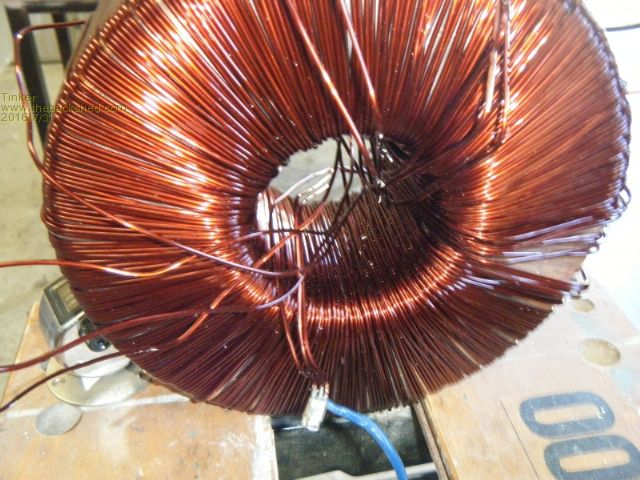

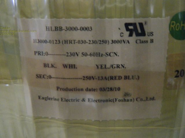

OK, time for an update to this thread I originally started.
The electronics for this project have been finished for quite some time and my Aerosharp 3Kw toroid transformers were waiting patiently for me to tackle the rewinding.

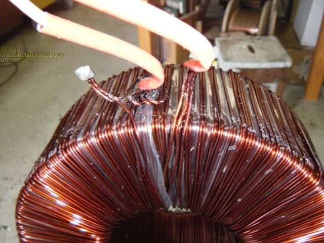

As soon as had I unwound the mylar film strip hiding the connections I started wishing that I had procrastinated a little longer.....
The top winding (250V) was wound 3 in hand with 1.8mm diameter wire, nothing unusual there. Only this time they wound the 'three in hand' literally. Yes, three wires side by side wound on at the same time.
Nothing like the 'wind one wire at a time and then connect them in parallel' idea I had faced with my first toroid conversion (tinker's inverter project).

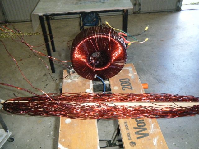

So, off it had to come, all three wires were wound onto my shuttle at once.
This was about 10 times harder to do than the one wire at a time method. My shuttle was getting very full with all that extra wire. And just to give me more challenges they managed to sneak in the odd riding turn (one wire being trapped under a subsequent turn of the same wire)which is not easy to clear with three sets of wires adding to the confusion in the toroid hole.
Luckily they only wound on one layer then joined the wires for the next layer so I had a ready place to apply my side cutters.
There was no mylar tape at all wound on between the two layers, perhaps the factory had a tape shortage as I noticed later on the inner, 230V winding had only a non complete mylar tape covering.
Anyway, with half of the 250V winding now on my shuttle I had to carefully unwrap it along the floor of my garage and adjoining workshop, some 20m distance in total. The wire was longer than that.
Now came the tedious task of separating the 3 wires which, naturally, were by now twisted around each other. Then I straightened each wire so it could be coiled for future re use.

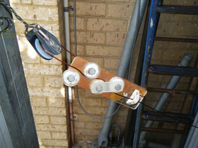

I use this idea for wire straightening after first pulling the wire through the funnel like shape of a cartridge gun nozzle to remove the bigger kinks.
The wire is run through the sheave tied to the door frame. Its end is fastened to the straightener and thus I effectively could straighten wire twice as long as the 20m distance I had. Which was just as well as the rain outside did not encourage walking out the shed door pulling on the wire.
Then came a repeat of the above with the other half of the 250V winding.

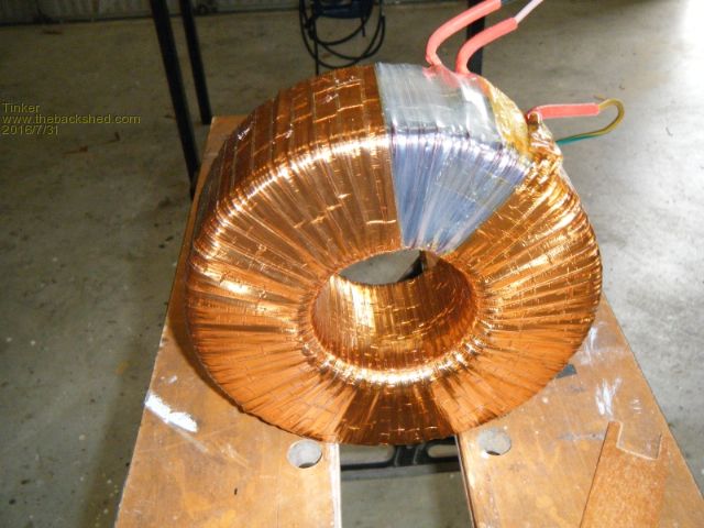

On this toroid the electrostatic shield was in copper foil which pleased me, much easier to re use than that horrible alu foil strip they used on my first toroid conversion.
The 230V winding was, thankfully, wound one wire at a time. It was also a 3 in hand winding of 1.8mm diameter wire.
After straightening and coiling all the wire I had 7kg of it and another 7kg to come.

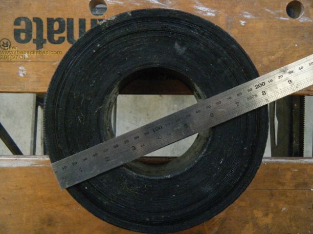

A good size core was found under all that wire.
This one, at 203mm OD is bigger than the 190mm OD core I got for my first inverter project.
A twin stack core will give me 7420mm sq of core area which calculates to a theoretical ratio of 2.47V/ turn.
I will be using the lower ratio of 2.3V/ turn which I got by experimental measurement and use 100 turns for the secondary. Using 4 in hand of the 1.8mm wire should make a very robust winding.
I'm not sure yet what to use for the 11 turn primary but definitely not the many many thin wire in parallel idea described elsewhere here. That one is in the too hard drawer in my workshop.
Surprisingly, when I compared the labels on my toroids (which were all made on the same day) the toroid windings were quite different from what madness posted on his toroids. All were made by the same manufacturer and mine only made a few days later of the same month and year.
So, anybody starting up an inverter rebuild project, you are in for some unwinding 'fun' if your donor Aerosharp toroid transformer bears the above label.
Posted: 02:15am 31 Jul 2016
I have unwound some with the same label, with a bit of fiddling I found the last wire to wound on and away I went 1 at a time.
Looking at the price of heavy gauge wire I would wind the same as before with 2mm wire on the primary. I have been trying to continue straight on to the choke with it but I may give up and use something else for those 3 turns.
