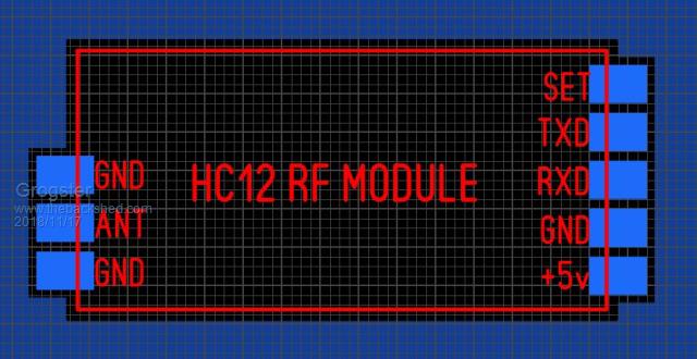

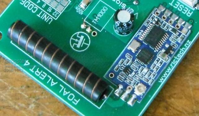

HOW exactly are you mounting your HC12's to the PCB with the antennas?
You seem to know your RF, so I don't expect you have done anything silly here, but I have to ask.
This is how I currently mount my HC12's, and they work very well. Note that I am also using antenna PCB track of 2mm which is a frequency match for around 433MHz. If your antenna is mounted externally via the UFL socket, then you really shouldn't be having any matching problems at all.
[/quote]
I've updated the info at http://support.rossw.net/hc12/, but very similar to yours.
On the reverse, I removed copper to ensure it wasn't acting as a capacitor shunting signal to ground:
[quote]
Yeah, that's what I figure too. And I've done a DC continuity test from the ant pin on the HC12 to the other end of the cable where it plugs into the SA incase any cable or connector was damaged - and I have DC continuity, and no short from centre pin to braid, so I'm puzzled.Edited by RossW 2018-11-13

Ross - the only thing I can think that is different to how I am mounting the HC12, is that I totally get rid of any ground-plane around the module on my PCB footprint:
I always try to avoid running any tracks anywhere under this footprint, either on the top or the bottom copper. You use much more copper GP on your footprint, but I really don't see how that could lead to such a drastic drop-off in output power, but perhaps the GP on the HC12 and the GP under the module on the PCB footprint are acting as some kind of ground-coupling capacitor at RF frequencies.
The fact that you get the expected output power with the module OFF the PCB seems to point to some issue with the PCB, if the power drops off when you put it back on the PCB.
EDIT: I assume you have actually set the HC12 to run 100mW output power? I think they come from factory like that anyway, but you CAN change the output power via AT commands in setup mode. I expect you probably know that, but I have to ask to be sure that isn't the issue with your power output problem.Edited by Grogster 2018-11-18
