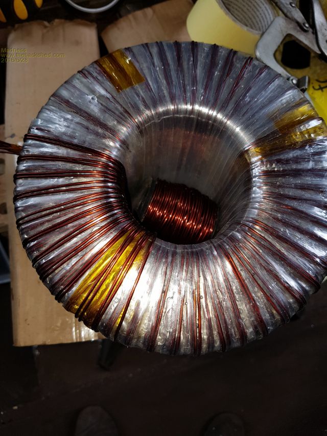

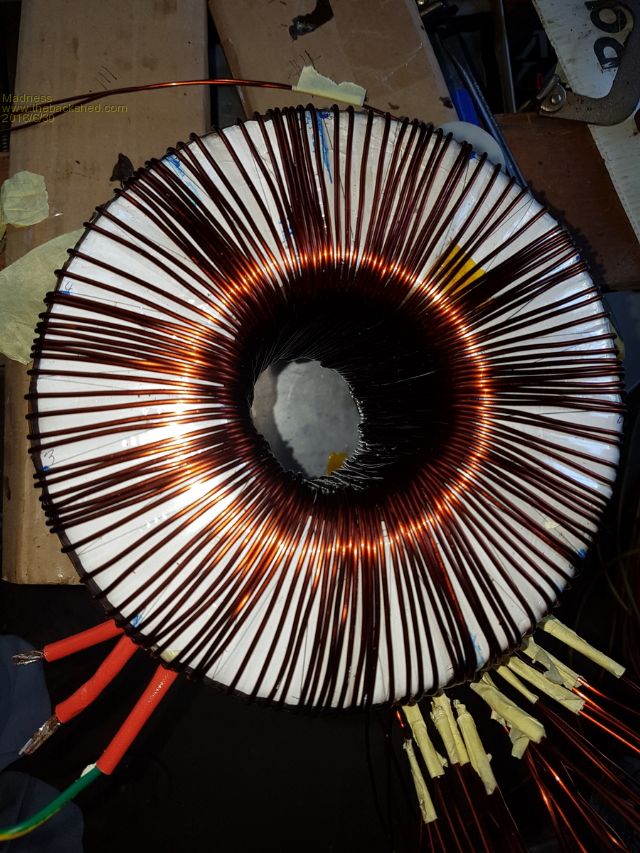

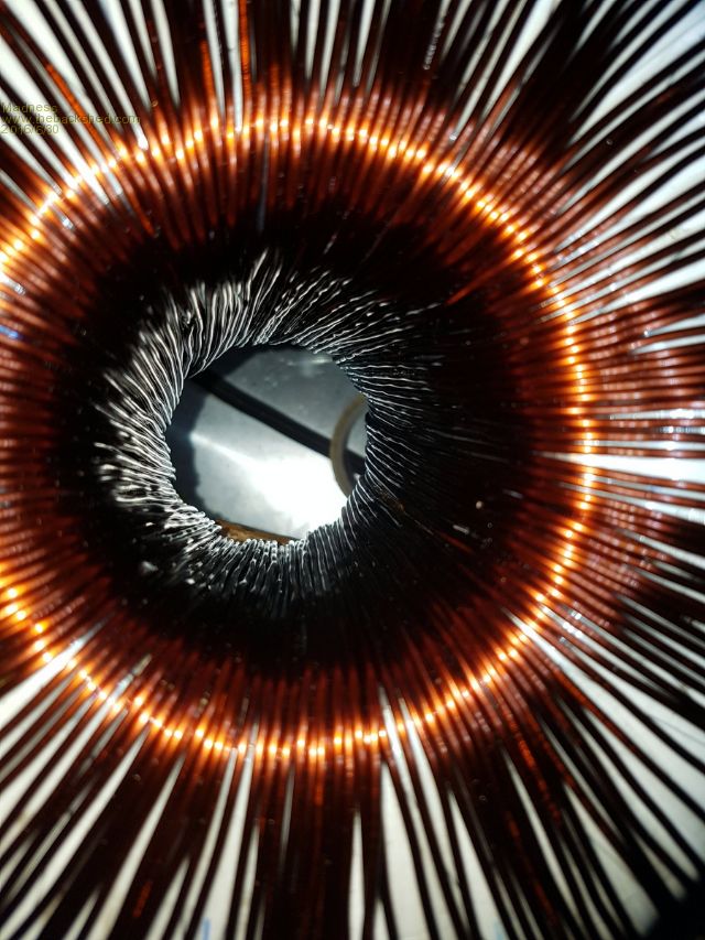

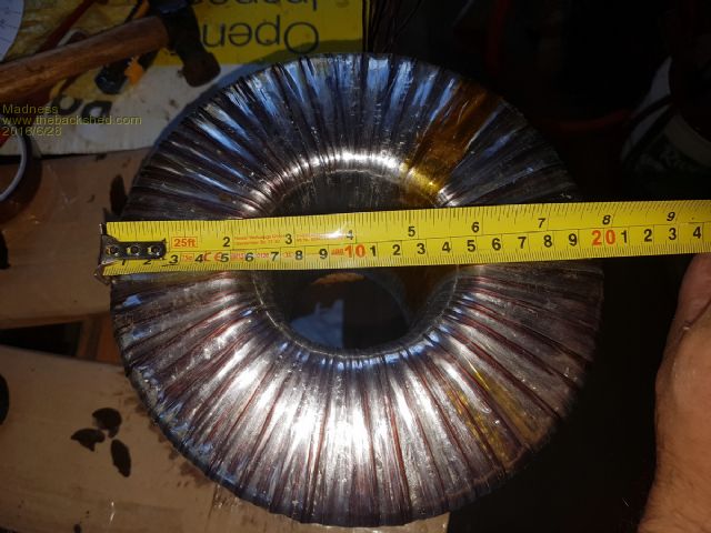

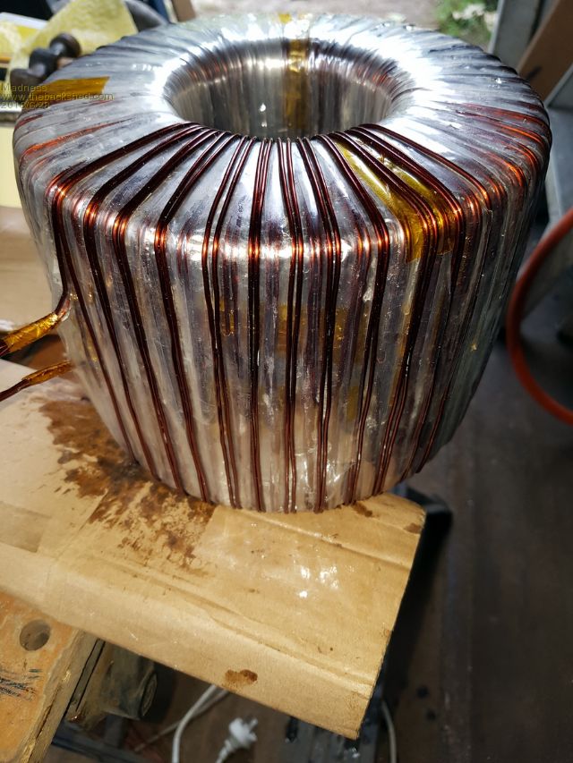

Making progress with the monster Torroid, I have put 4 layers of 1.6 mm wire on, these photo's are the during and after the last (4th) secondary winding has gone on.
Tomorrow I plan to start winding the primary using 1.6 wire, 11 turns I should be able to get a first layer of 15 in hand and then another layer with 14 in hand. That will be a total of 58 mm square of copper, I know Oz thinks I am mad for trying this, but when people tell me you can't do that I have to prove them wrong.
I quote Oztules here from another forum " There are probably better ways of doing this stuff, and I'm all ears." Maybe you are right Oz that 1.6 wire is note the best way to go but then... Not trying to disagree with you Oz, I think you are very talented. I want to try to keep the Torroid as compact as possible along with the reduced size of the power board above using the original external heat sink. So that I can fit every thing in one Aero Sharp box. Also with the extra windings it will be able to run cooler. I will post more results soon.

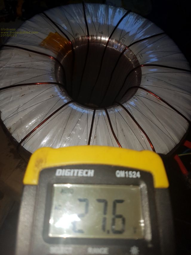

Just tried 11 turns and only got 24.4 volts with a 228 on the secondary. So put another turn and got the result shown. So looks like the calculations or measurements where out somewhere.

Recheck the figures... something is wrong when your last turn added 3v or more
On your initial figures, I see 240v would make almost 26v as guessed. ie 228 made 24.4 or 9.34:1... so another 12v would yield 25.7v close enough really... a point 3v error is not bad.
Your extra turn created 24.4-27.6 = 3.2v..... how, when your first 11 turns only made 24.4/11=2.21v

Checked it again, thinking back my wife had the oven on so may have been some voltage variations. Must be going mad I have 98 turns on the secondary 98/8 = 12.25 where did I get 11 from
Checked voltages again and took photo's so can't be a memory thing
constant 228 volts on secondary
11 turns = 25.3
12 turns = 27.8
27.8 - 25.3 = 2.5
2.5 X 11 = 27.5
2.5 x 12 = 30
I know you say through the hole is a turn but if one is 10.75 turns and the other is 12.2 will they still give exactly the same volts per turn?Edited by Madness 2016-06-30

I think it is your digital meter measuring an unloaded transformer.... it is slightly unnerved from the looks.... but only in the second digit..
This is the real problem:-
"Just tried 11 turns and only got 24.4 volts with a 228 on the secondary. So put another turn and got the result shown. So looks like the calculations or measurements where out somewhere. "
That says you misread it.... as now you get 25.3 for the same measurement
However.... yes a turn through the middle is all that counts.... load will make a difference to the measurements perhaps.
I make it as 2.3v/turn as a reasonable value.... so 11 turns. For a 228v grid, then you will get about 25.3 volts.
I expect almost 9:1 for this effort, so I expect 26.6v which is where we wanted to be in the first place for 240v grid
So 11 turns is probably the right amount for the 8010 under all operation voltages I expect ...... 12 turns will give you pretty much the same thing.... I would not be pedantic.

Thanks for the reassurance Oz, 11 turns it is then. The photo from before was a test with some 1.6 wire, I will be winding with 2 mm. Have a 75 mm hole at this stage, the Aero Sharps where down to about 50mm. If all goes to plan I will get 1 layer of 11 in hand, 2nd layer 10 in hand and 3rd layer of 9 in hand of 2mm wire. Should still have a 60mm hole and 62mm square primary. That will also fit easily in the choke.

I am using 2 MM for the primary so 20 in hand will give me 62.8 Square the 8 x 1.6 secondary is 8 mm square so very very close to your "matched copper" target. The plan is to build it to be bullet proof, at least the Torroid part, it is easy to make spare boards to have on hand, but if the Torroid failed that would result in some four letter words.
If it turns into mess I will retreat back into my hole and shut up.

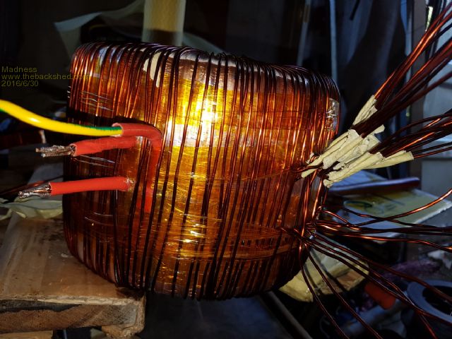

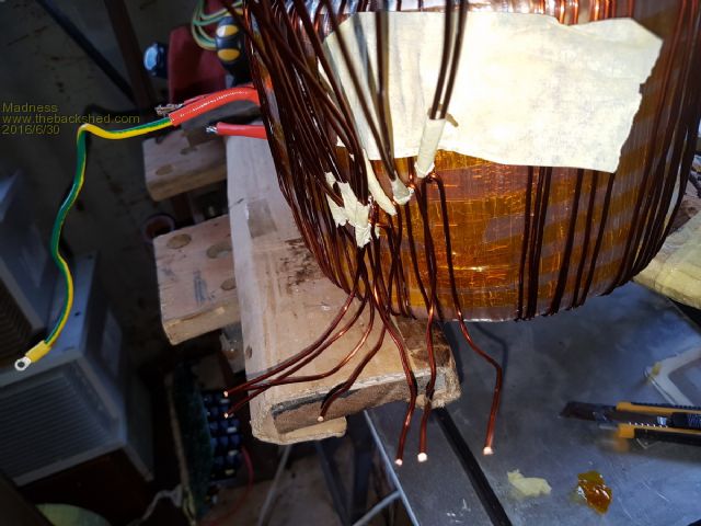

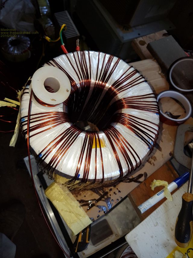

Primary windings are going on reasonably well, but I would say if you don't have good reason to recycle the copper wire or save space then save yourself some time and effort do it Oz's way. Have 12 wires out of 20 on so far.
Posted: 09:15pm 29 Jun 2016
15 turns on 5 to go, I am happy with how it is going.

For my transformer it would need 6.5 metres so $130 worth of wire, based on that I would do it the way I have.
