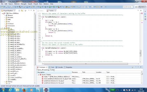

plasma
Joined: 08/04/2012
Posts: 437
Posted: 10:25pm 13 Feb 2016
2016-02-14_082834_stm.zip
hmm i got this
thxEdited by plasma 2016-02-15
Posted: 10:44pm 13 Feb 2016
This is a result of a recent update to the development environment which I downloaded yesterday. To get round it you need to declare the relevant functions external in the C file as well as the header file - I've no idea why - makes no sense. so add the line
extern inline int str_equal(const char *s1, const char *s2);
into MM_misc.c and MM_misc.h
The problem only seems to relate to functions declared "inline"
