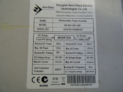

Anyway, I managed to do a very reasonable barter (with a local forum member) for a 3Kw Aerosharp grid tie inverter. I would like to make a LV inverter from that, as big as its 15kg (incl windings) toroid can handle.
My battery bank is going to be 50V/ 200Ah LYP (presently connected as 25V/400Ah) to a smaller LV inverter.

The aerosharp specs were:

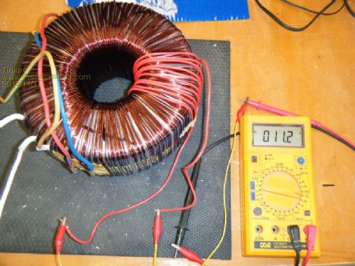

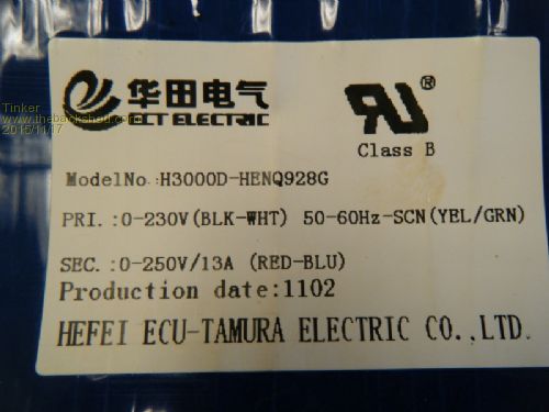

The toroid specs:
The 230V winding connected to the grid is on the inside, the 250V winding is outside and is 3 in hand of 1.5mm dia wire ea.
I did a test by feeding exactly 230 VAC (via variac) to the 230V winding and measured 250VAC on the other winding and the picture below shows what's on a temporary 10 turn winding:
Now my question is how to best proceed.
Should I unwind the 250W winding altogether?
Should I unwind just enough turns to make the exact same voltage as the 230V winding and then parallel these?
The toroid hole now is 65mm and I could fit 45 turns of 8mm OD cable (120A)max.
The long fieldlines messages suggest a lot less turns but they are for worst case LA batteries, what works best for my lithium batteries who will never go below 48V?
Any other suggestions are welcome, no doubt I'll have more questions when the PJ boards arrive in a months time or so.

For the best power handling we want the secondary to be solid.... so winding 18 or so turns onto the outside connected in series with the 230v winding should get you a very heavy 250v winding when paralleled with the original of 5 or 6 in hand... bigger than anything I have done thus far.
The 250v will give you less magnetizing current, so better idle.
250/8=31.5v primary.... 31.5/1.12=28 turns for the primary... so maybe 35mmsq for that will fit?
This will keep the sag out of the secondary, and the 35mmm will do fairly well, and is easier to cool than an internal winding.
Is this what you were after?
The limiting factor for a transformer is the copper loss heat and sag.
Once the proper turn for the voltage and frequency have been established, using a sine wave you cannot saturate it by driving more current through it... not even a short circuit.
The extra amp turns is not used to drive more field into the core ( which would saturate it), but is involved with the current transfer between the wires involved via induction.
So in theory if we used super conductors, we could use fishing line width wire and have massive kw transformers in a very small package.
There are many people who think shorting or overloading a transformer leads to saturation, and that is what kills it... but it is not so... it is the copper losses adding up that fries it in o/load conditions.
It is useful to remember this, as using two cores as I have ( and even three) does not push up the power handling in itself because of core size, but allows thicker wire, that stops the voltage sag, and copper losses... this is what dictates the power handling and heating problems.
If you use both primary and secondary winding off the tranny, you will probably have a better transformer than my twin core for that part..... then it is how much copper you can get into the primary will dictate the power handling ( duty cycle dependent).

But something puzzles me (and as a retired electronic technician I ought to know this ) where does the "8" as in 250/8= 31.5 primary come from? Perhaps you explained it elsewhere but that fieldlines post is rather long....
With my measured voltage of 1.16V/turn I would assume the 230V winding being close to 200turns and the low voltage primary requiring around 45 turns ???? I think I'm missing something here.
I had another look at that massive toroid just now, unfortunately I can push only a 60mm diameter wood disk through its center, must have gotten the first measurement wrong.
Drawing a 60mm circle and finding out how many 10mm circles fit inside (10mm = 25mm sq 200A multistrand cable as used for welding cable) will now only accommodate 27 turns max, leaving zero space for a mounting bolt. No chance of 28 turns of 35 mm sq., not sure where to source 35 mm sq cable either, the flexibility of multistrand does appeal....
So I'm now thinking to rewind the entire toroid 4 or 5 in hand with the 1.5 mm wire, a lot more work though but at least I could epoxy up each layer then.
Pity if it comes to that but I prefer to do it very well and have plenty of time for this project.
Further comments please.
P.S. Using a variac via a 1:1 isolation transformer to test that toroid completely negated the requirement of requiring an incadescent lamp in series. All my house fuses are still intact

8:1.....Buried in amongst the 130 odd pages over at EMatters forum, we found that that was a useful rule of thumb. It takes into account losses, low battery, sag scenarios etc... and seems to work pretty well. 45 turns would probably clip under high power, low batt volts, from winding sag and lower ratio.
If your going to rewind, there are some things I would try now... experience leads to more ideas.....
The hole size is the problem, and another rule of thumb ( very rough) is that about 2800mmsq of steel per volt per turn seems to be a workable unit.
From this, if you tear the torroid down to it's core, it will be a very useful thing to pull probably 10mm of inner core.... out. so your current core will be about 1.12 x 2800 for about 3136 mmsq... when you get it bare... check to see... adjust rule accordingly.
I think from memory, the core is about 70mm high... so if we lose 700sq mm of core to get a 20mm bigger hole to play with, we will lose about 700/2800 or .25v/turn.... significant yes, but countered by having a huge winding hole that will take lots and lots more copper to compensate.... so probably .87v/turn or 270 turns instead of 205 turns for 230v winding.
If your real keen, you could wind that steel onto the outside and get maybe .12v back, possibly worth the work. The big hole will allow decent bobbins to be used, making it easier and much more enjoyable work.... more turns but easier.
Keep in mind that you should... ( but wont) have balanced copper in the secondary and primary re cross section..... ie if you used 3 in hand of 2mm wire for the secondary it would be 9.5sqmm of copper total.
To balance the primary...... the primary should be 9.5x8 or about 75mmsq... not likely to happen, but gives you an idea of how strong the secondary will be... cooling on the primary is very good, so 35mmsq would be fair. 50mm better.... etc...... 75mmsq won't happen unless you are doing 24v.
So many compromises it;s a wonder it works at all....

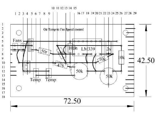

Is there a circuit posted somewhere for that neat fan control in your inverter modification page here ?
I see the PCB layout but as I brew my own PCB's a circuit would be nice to have.
And, do you have a source for that neat 4 x DPM red digit display that is shown on your monster inverter front panel?

I tend not to do circuits, I just get the protel pcb program and design on the run...and then make the board.
I am not an engineer, just a hobby hack, so I get the pin outs of the chip I want to use and just go.... not very usual I know, but I don't have circiuts of anything I make... I just build it... stuff it up, change a few things and then there it is..
There will have been a scribble here and there of part of some of the things as they are complicated sometimes ( pwm power supplies, etc), but just a scribble here and there to incorporate into the on screen design.... lazy or silly, not sure which...
Just reverse engineer it if you want to see how it works, but it is just a few op amps and a fet.
However, I think someone has done a circuit for you... possbly clockman on fieldlines or anotherpower

Here's Oztules circuit put on breadboard. Its compact but tidy.
See fieldlines for component values etc.

The only problem with those sort of controllers are that they are bang bang things.
The best way to control temp in normal operating parameters ( low to medium power ) is with variable control, as the fans will run at slow speed, and be silent for a lot of the time, instead of on -off-on full bore..... I detest that in my work area, when a slow stream of air would prevent the temp rise in the first place.
However, if your gpoing to push it hard, then the difference is mute.

"What puzzles me though is that oztules uses a comparator and to my experience these things are either on or off - and should give a "bang bang" control"
Both are just op amps.
"op amps" generally have their own output stage, and comparators generally have open collector outputs.
Op amps have slow slew rates, and compartors are op amps optimised for high slew rates.
So either can be used in just about any application, it is the surrounding circuit that takes advantage of the different output stages and slew rates.
I used the comparator, as I wanted either fast response ( bang bang style ) tight cross over control, all the way to vey mild gentle cross over from full drive to no drive and every where in between.... just adjust the feedback pot to get whatever you want.
I was going to use pwm so the 339 was the obvious choice... but the fans use so little power, that linear use of the fets was simpler... but the 339 stayed.
Both Glens and mine use the same feedback path to achive the same thing, but the difference is the op amp has it's own output stage, so no pull up resistor is needed.
They will both perform the same if you choose the right components around them... (and the pots do that for you.)
Feedback changes the rates of change in both as expected, but the slew rate in the 339 is much higher, and so feedback needs to be a bit more savage to control it's gain.
Put simply, comparator is a high slew rate optimised comparator with open collector output ( needs pull up's), op amp is a differential amp not optimised for max slew rates, but rather a more linear feel, but both can do the same job in essence, but do their particular style of amplification optimised for different purposes..... feedback changes both from an amp to a switch I guess is how I look at them both.
