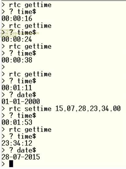

Posts: 10114
Posted: 01:14am 28 Jul 2015
I have a 3231 hooked up, but the RTC commands do not seem to be working for me.
I can RTC SETTIME and RTC GETTIME, but the results are not saved or loaded.
Example: RTC SETTIME 15,07,28,23,07,00 - this command completes fine. Remove power and replace. RTC GETTIME completes fine, then ? time$,date$ results in the default power-up date and time: 00:00:30 for time, and 01:01:2000 for date.
If I remove the SDA and SCL lines and issue the same commands, I get the standard error: "Error: RTC does not respond.", so I think that the MM+ can see the RTC chip, but something is going wrong with the commands.
So, RTC commands are not working on this module - can anyone else with an RTC please check and confirm this?
...we might have a bug here...
I will hook up my logic analyser and check the signals.
EDIT: OK, the I2C is going out, but the MM is not updating the RTC when you issue a RTC GETTIME.

Posts: 10114
Posted: 01:48am 28 Jul 2015
Interesting.
The plot thickens.
RTC GETTIME only seems to want to work AFTER you set the RTC.
It will not get the data from the RTC chip on powerup.
So:
1) Power up
2) RTC GETTIME [Fail]
3) RTC SETTIME [OK]
4) RTC GETTIME [OK]
5) TIME$="00:00:00" [OK]
6) RTC GETTIME [OK]
So, from power-up, the MM+ does not want to get the time from the RTC, until you set it, then it does.
Bug?
Here is a shot of TT:
Edited by Grogster 2015-07-29
Posts: 3372
Posted: 02:33am 28 Jul 2015
This sounds very much as if there is a fault with either the crystal or the battery on the RTC.
I have had this problem in the past, what happens is that when you issue the RTC SETTIME command MMBasic sets both the internal MMBasic clock and the RTC. However, when you remove the power the RTC looses the time so it is reset to zero on the next power up.
I can check the RTC code when I get back to my workshop but I doubt that MMBasic has a bug, the fault is probably in the RTC.

Posted: 02:55am 28 Jul 2015
DS3231 module is working fine for me on MM+, also tested PCF8563 and DS1307 - all work properly.Edited by matherp 2015-07-29
