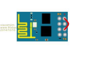

viscomjim
Joined: 08/01/2014
Posts: 925
Posted: 05:32pm 15 Oct 2014
HERE is the wiring diagram I used for updating.
The only difference from the regular wiring that you have in the instructable is that you have to bring gpio 0 low while programming. After programming, unhook gpio 0 and then I just power cycled the unit. I wired the unit directly to the usb to ttl serial board as described on that page - just don't do any of the steps listed on that page other than the wiring.
Then this...
Firmware uploading tool
File:XTCOM UTIL.zip
How to use
Download the bin file
Set the module to update mode (by tying gpio0 low),
connect the module : choose "tools" - "configure device"
Upload bin file: API Test - Flash image download, upload the bin file at 0x0000
This picture is the wiring for "normal" use. Courtesy of OBC's instructable.
Going to get some sleep now. Good luck!!!
Edited by viscomjim 2014-10-17
