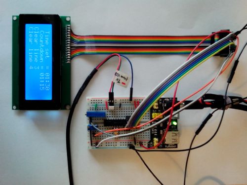

Another confirmation that the beta7 LCD routine works well on a 4 line display. This time using the white-on-blue J204A module that was $9 on DX.com last year. It looks pretty good.
From the info I've managed to glean, this display uses the SPLC780 controller, which Geoff could add to the KS0066 & HD44780 compatibles he's quoted in the Manual.
One hassle with the 'datasheet' given for the module was that the 'standard' 16 pin connection shows DB0-DB3 as the 'data' bits and DB4-DB7 as not connected. This is the reverse of Geoff's diagram on page 18 of the MicroMite manual and Geoff's version is correct.

there were a few points that caught me out when I was getting the 20x4 LCD module going and I think would be worth including in the Manual.
1. Firstly the comment I made in the post above about the reversed DB0-DB7 documentation shown for a lot of modules from the cheaper suppliers, i.e. eBay and DX.com.
2. Secondly, the pin3 'contrast' connnection needs some clarification (and it's also pretty unclear on other datasheets). I originally assumed it worked the same as the backlight, i.e. needing a +ve and -ve supply as shown in the Manual's page 18 diagram. I duly connected pin 3 of the module's 'standard' 16-pin connector to the wiper of the 10K pot and the other ends of the pot to 5v & Gnd. After several hours of head scratching it turned out that (for this module at least) there should be no connection to the positive supply! If it is connected, lines 1&3 (only) of the display show up against the backlighting, but no data is displayed.
3. I've yet to see a datasheet mention that the contrast adjustment pot needs to be set before data can be displayed. I assumed that there would be some, or too much, contrast shown before the pot was set, but in fact nothing showed at all at my original mid-point setting. This makes life very frustrating when issues 1&2 above are compounding things. The point needs making that the contrast pot should be adjusted until the outline of the character positions can be seen against the backlighting and then that position should allow displayed characters to be seen.
Greg
