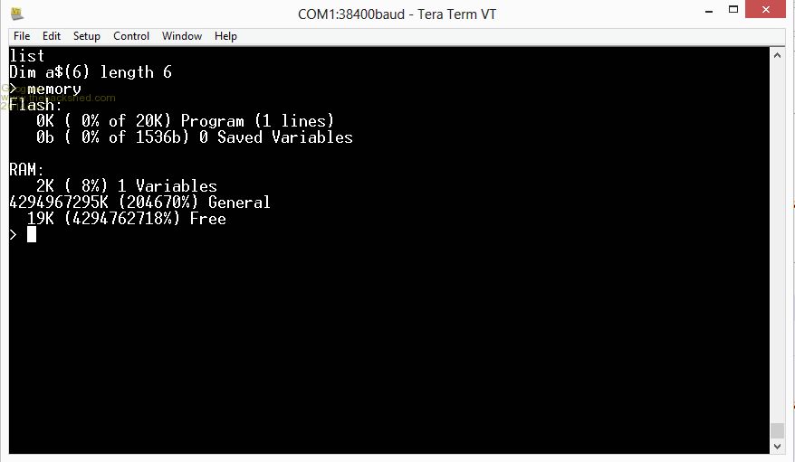

Posts: 10109
Posted: 12:40pm 17 Feb 2014
Confirmed.
Who needs the MZ series chips - the uM chip has 4294967295K(3.9TB! ) of RAM - cool!

  plasma said  dim a$(6) length 6
shows me 186536% in general ram
i am really interested for the ir receiver as Geoff shows in the beta 6 manual ,but unfortunately i cant get this in germany. can i use other receivers ?
Thanks very much Plasma (and Grogster for confirming it), that is what I would call an "entertaining" bug. I will fix it in the next beta.
Yes, you can use almost any receiver. They all seem to work the same and even have the same pinouts. The devices that I quoted in the manual were just examples.
GeoffEdited by Geoffg 2014-02-18

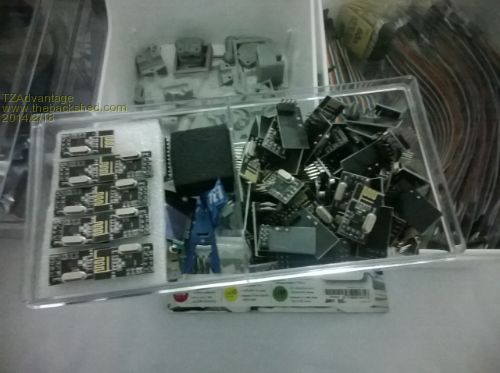

Posted: 06:47am 18 Feb 2014
WOW, support for the NRF24L01+ would be awesome! (And that from a 49 year old)
I used them on arduinos and they are (through using a library) super easy to use
Now the hard thing is of course the library and the one i use works good.
Thi is the library: http://maniacbug.github.io/RF24Network/index.html
It is in C(++), it creates a network of nodes using a tree structure.
Each rf modules can handle six 'pipes' at the same time making it possible for each node to connect to 5 others. The library takes care of delivering the messages by routing it through the right nodes. Works good.
Underlying is a simpler library that just talks between two rf modules. In many cases that can be enough
Another library i found that uses a PIC but did not use yet (never got a order through) is this: http://www.openbeacon.org/OpenBeacon_Active_RFID_Project
That is another great use of it, by using it as an active RFID it can be used for identification and security.
I am getting excited, because if one of those type of uses is available from MMBasic, just wow!
If you need a few for testing i have a whole bunch of them :) We use them in the makerspace with the arduinos.
I got about 100 meters range with those in open field. At home it works through at least 1 concrete wall/floor and 15 meters distance (Could not get more far than that inside, so practically the whole house, also upstairs.)
