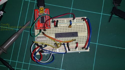

  TinkersALot said   This board should work for a beta-bed shouldn't it?
You don't have to get that complicated. I did the whole development on this breadboard.

  TinkersALot said   @elproducts:
Is this this usb-converter board you are using?
https://www.sparkfun.com/products/718
I actually used the older version of this one.
Sparkfun adapter
But either one will work. Yours is the same one Geoff uses in his picture which allows you to solder pins for breadboard attachment . Mine required wires.
