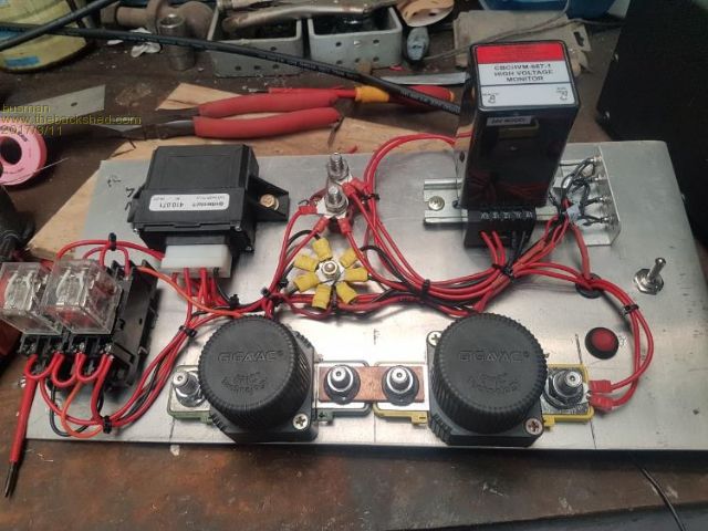

My banks in the motorhome (200 ah @ 12v winstons and 800 ah @ 24 v sinopolys are now over 3 years old.
At that time about all we could find for monitoring/protection were Junsi cell loggers, so the banks were set up using those as protection for out of balance cells.
One was set so if a Junsi alarm call for an over volt cell happened, a voltage stepper came into ply, sending a higher than programmed voltage (voltage sensing wires) to the Rich Supercombi power management centre. This made the SC think battery was over, so it told the 3 solar regs (all data cabled together) to stop charging. At the same time a water heating element was switched on to "pull back" any errant cell. After a set time, usually 5 mins or so (set by timer) it all reverted to what was happening before the vent. A counter told me how many times this had happened, or how much hot water I had !
Another junsi was set to set off a piezo alarm on high or low voltage.
The junsi only drew it's operating power from the first 6 cells, no problem for the 12 v bank, but 2 of them on 24/7 created an imbalance meaning you had to stop charging at a lower voltage and charge at a slower rate or 7 and 8 would run away.
Remember this was years ago and it was a real problem.
Now both banks are fitted with balancers, probably not necessary for the 12 v bank as they seem to stay pretty balanced anyway, but essential for the 24 using the earlier regime.
There has been call since then.
In fact the Junsi is disconnected, just plug it in occasionally to check, never more than 20 mv.Plug it in when travelling though.
However I have added a different level of protection.
On the battery positive lead I have installed 2 levels of protection, one is a high/low voltage cut out from VDO. The levels are adjustable and this drives a Gigavac latching relay. So if voltage goes past the high or low parameter the Gigavac "unlatches" and stays that way until I switch a current to it to "latch" it again. This way, if I am away the battery disconnects and stays disconnected.
I also have another high voltage only device driving a NO Gigavac contactor.
If the voltage goes over 30 this one drops out allowing the contactor to go to its normally open state. So fail safe is taken care of.
Why the 2 units ? It is electronic, therefore at some time in the future it will fail, maybe tommorow, maybe 100 years, I don't know when.
Also I use solid copper bars 4 mm thick to join my cells (64 in big bank) with no problem, been through a wide range of temps as well. I know the logic says you must buy expensive links but that is not my experience, the copper bar is many, many times cheaper than links.
Oh, and from my experience, with a balancer in place you do not really need much else. If I was to set up another system it would have a balancer and similar high/low voltage protection. These cells can take a lot of abuse, even if you had a single runaway it would not get to any dangerous area, if you have your parameters tight.
So, there you are, my current BMS, all off the shelf, anyone want to buy version 1 ?

Hi Busman,
Your gigavac latching relays aroused my interest as I was not aware of that brand.
However, on their website there seem to be only high voltage latching relays I could find.
What I would require; to replace the 12V 80A latching relays I had used with my 24V battery bank but are too low voltage for safe usage on the 48v bank; is a latching relay that could disconnect 150A @ about 56V DC.
This would be the worst case situation should something short out the bank while I'm away.
What rating is the relay shown in your picture? And where did you get it from?
With my 24v battery bank I used a back to back 120A schottky diode in series of the battery cable.
These diodes were normally shorted out by a latching relay across each.
Over voltage would trigger one relay, preventing further charge flowing into the battery but it still powering the load.
Under voltage would disconnect the load but leave the charging side intact.
Thanks.

Hello Klaus,
Gigavac is well known, they do make a great product.
My bistate (latching) relay is http://www.gigavac.com/sites/default/files/catalog/spec_sheet/gxl14.pdf
350 amps. Only listed as 12/24 v coil but I have found them to be very easy to work with and would not be surprised if they will make one with your required coil voltage
I brought direct, the guy you want to send an email to is Marcus, send it to info@gigavac.com and mark it for his attention and ask if they can make one of the above with your size coil, I would not be surprised if they say yes.
Not cheap but then what piece of quality equipment is ? About $200 by memory.
I have about 4 in my setup, I use 2 NC to divert 2Kw of solar to my hot water heating, through 3 pairs of elements, each a 12 and 24 volt in series.
1/2 an hour in the middle of the day gives me 50 ltrs of very hot water.
Hope this hepls,
