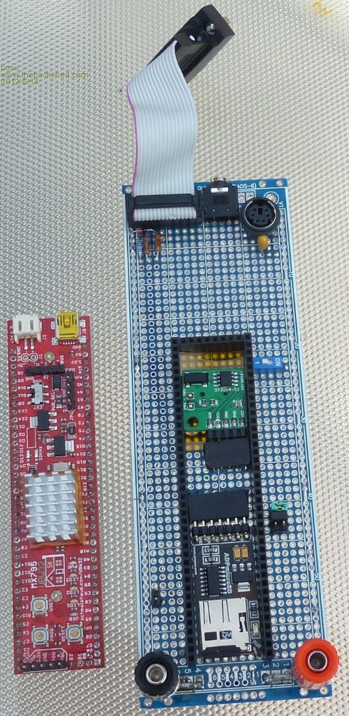

here is it. The original picture has 3+ MB and is enlosed as zip file. Yes I decided to use a small heatsink to lower CPU temperature, the reason is a future plan for overclocking the chip.

  boss said   Greetings from Canada,
Especially for SD card, it means the shorter connection is the more reliable the function will be. Finally I found both modules (RTC+SD) suitable to be installed under the UBW board (see picture). All modules are available on Ebay. And it works like charm.
http://www.ebay.ca/itm/DS1307-Based-Real-Time-Clock-Arduino- I2C-Tiny-Size-20x20mm-Any-uControl-/330778120169?pt=LH_Defau ltDomain_0&hash=item4d03e98fe9
Reagards
boss
Hi Boss,
Your e-bay link has the RTC available but not the SD card. Do you have a separate link for that or have they sold out maybe?
Greg

  paceman said
Hi Boss,
Greg
Hi ,
You don't need this Greg , everything will be on-board in the
ColourMM
If you use a UBW32 board then just the SD card is needed , the RTC is
optional and it will not freeze your MM if not present.
Cheers.
Darth.

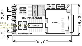

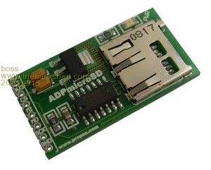

here is link for SD card module.
http://www.ebay.ca/itm/150871163914?_trksid=p5197.c0.m619
The SD module is made in Poland and price around $6 + $4 for shipping.
RTC is not necesary as darthmite mentioned but is is handy to have it.
boss

  darthmite said
Hi ,
ColourMM
Cheers.
Darth.
Hi Darth,
Yes, I saw from Geoff's comments that that would be the case and like Nick I'm really looking forward to the Sept SC issue! I'm thinking ahead though to what I'd use for embedded future projects, hence the interest.
Cheers, Greg

Posts: 268
Posted: 10:19am 15 Aug 2012
Hi Darthmite,
this SD adapter and this is not suitabble under the UBW installation because of dimensions. See
boss
