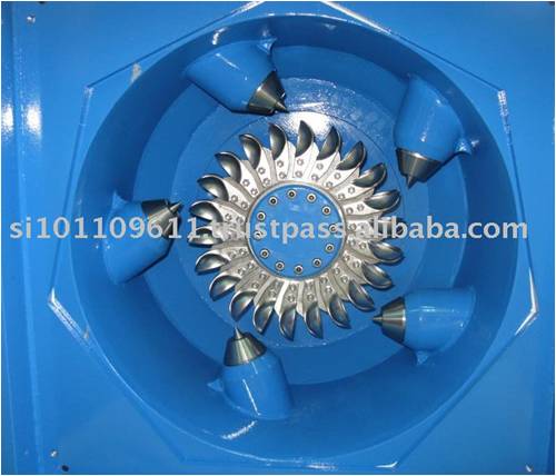

There is always a tradeoff with homemade stuff. I look at your wheel and think, wow, I couldn't afford to pay for all those PVC elbows at retail prices. PVC is quite brittle, you may get a lot of wear at the point the water hits the spoons centre ridge. If the rig proves it self and works well then long term the commercial replaceable poly spoon may end up a cheaper option.
I was wondering, would there be any advantage if a swirl plate was fitted inside/behind the nozzle? The water could be focused into a small hollow cone instead of a point making it easier for the divider in the spoon pair to split it. this technique is used a lot in fire fighting equipment and agricultural sprayers for certain applications.

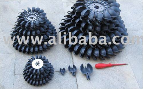

Cups should be 5 times the size of the largest nozzele used. I have cups here that are about 30mm but i am sure there is a supplier in the States.
Cost here is about $5 (nz)
However the efficiencies you Have been getting here seem justify you proceeding with your approach. I have build a lot hydro's been involved with a lot more and with micro hydro's the efficiencys range from 30% to 60 %.
when the water hits the wheel it ideally should deflect 180 degrees this is immpossible pelton designs for 165 .
Water hiting a flat plate will in theory max eff possible is 50% so bearing losses etc are on top of this.
