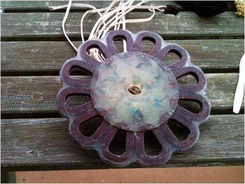

Well I'm having a problem.
Took the lid off the mold yesterday morning, the epoxy had set hard and it all looked good, just a few bubbles and valleys that needed filling. So I mixed up another batch of epoxy, popped the bubbles close to the surface, filled them and the valleys, then screwed the lid back down.
Its not setting Its been 24 hours now and this latest epoxy mix isn't setting hard. I've tried heating it, leaving it out in the sun, etc, but so far its still not set. It has the consistency of cured silicon, I can press my fingernail into it, and the surface feels wet/slimy. Any suggestions? Is it possible to dissolve the uncured epoxy out and try again?
Here it is with the lid off, out in the sun again to try and make this stuff set.

If it were me, I'd just let it set for a few days and see what happens. Is it possible that the hardner did'nt get mixed strong enough? While pouring a large batch a guy can cut back on the hardner to help control the heating, but with small batches for patching I mix it pretty strong. It should set hard in time, how much time ...I don't know, 3 days to 3 weeks.

if the touch up work with the epoxy isnt going off , i,d be inclined to give it a good wash off with an alcohol based solvent ,release it out of the mould and try again when its clean....car bondo is good for cosmetic work...
the stator looks really neat from the pic ...i wonder if some of the release agent has got mixed in a bit with the last touch up pour of the epoxy ?....
epoxy seems a little more critical in getting its mix right than vinyl ester or poly ..
but as long as the main pour with the glass cloth is sound everything should be ok ..
with all those coil islands getting it out could be interesting ...

I'll give it a day and see how it goes. I dont really have much choice, the non-curing epoxy is in all the nicks and crannies around wires and coils, I wouldn't be able to dig it out, and I'm worried if I use a solvent if it will affect the cured epoxy from a day ago.
It was a structurally sound before this latest mix, I just wanted to fill some holes and make it look its best.

I don't know what sort of epoxy you used (I may have missed that in my reading of the thread someplace). With fiberglass resins, if you do that, the stuff will never cure. I've tried heat lamps and even spraying the surface with MEK. The MEK will react and harden the surface but it still stays soft underneath.
Any time I've had that happen when doing fiberglass work I found the only real cure is to scrape out what you can, wipe it down with acetone and do another hot mix over it.

Yeah doing that. I've dug out most of the goo and cleaned it up best I can. I'll mix up some 5 minute epoxy to fill the holes and seal any goo I couldn't get to.

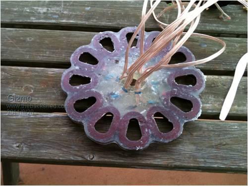

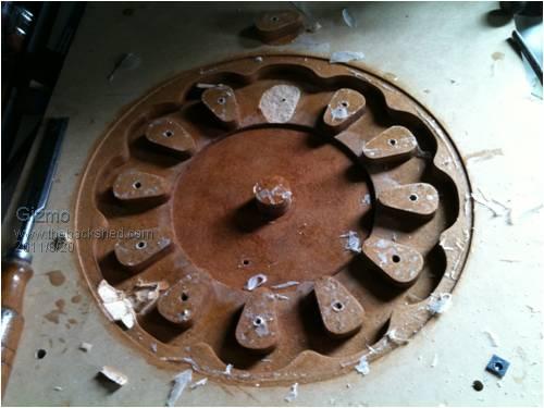

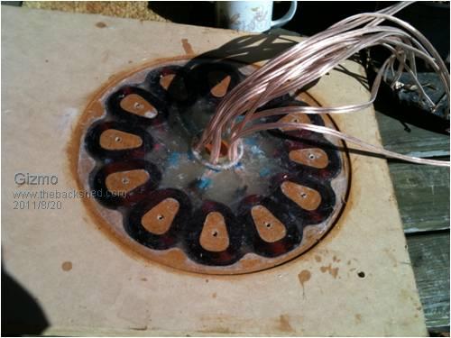

Posted: 04:55am 20 Aug 2011
Using Bob's compressed air suggestion, the stator poped off the mold easily, but jammed up on the coil centers, so I used a chisel to give me some grip on the edges and it came apart without any drama. Only one of the coil centers broke off.
Now I'm just filling a few holes with 5 minute epoxy and then I'll drill the mounting holes.

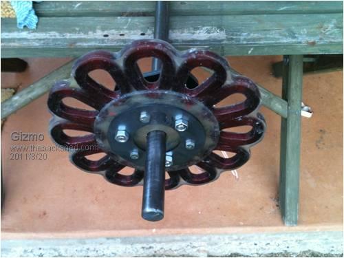

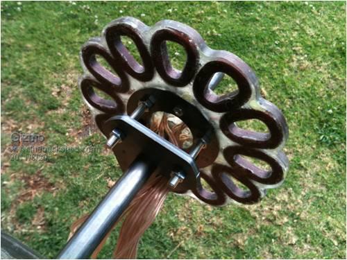

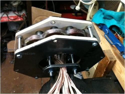

More pics. Fitted the 2 stator plates. These bolt to each side of the stator to give it its strength and keep it in shape if it gets warm. Epoxy or resin can get soft when it gets warm, like when the alternator is under load, and deform, leading to the stator rubbing against the magnets. Hopefully these plates will stop that, plus provide the 3 mounting points to the stator bracket, which is welded to the 25mm center shaft. The 3 threads will allow me to position the stator with respect to the magnet plates, not in this picture. I can adjust the stator position and magnet spacing without pulling the alternator apart.
Next I need to reposition the magnets on the magnet plates. This thing has grown in diameter by about 10mm since I make the magnet plates, so I need to make a few changes. A job for tomorrow.

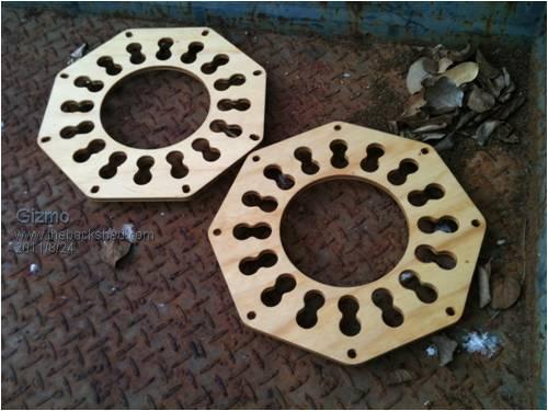

Anyway, more done today. I CNC'd out some 7mm ply into a magnet positioning plate. It has holes to position the magnets and will be a permanent part of the alternator, though I'll need to seal it to make it waterproof before it see's full time service. Then I assembled the alternator, I was getting impatient to see if it was going to work.

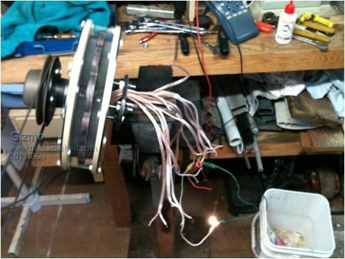

This is the lightbulb moment. Its driven from my lathe at about 150rpm and there is a 5w 12v lamp across one phase ( 4 coils in series ).
Ran it up to test speed and I was getting 40vp-p cross one phase at 225rpm. Thats 20v peak. In a 3 phase star configuration, that would be 34v. Working back, I reach a 12v/24v cut in RPM at about 160rpm. Remember I have 4 coils per phase, so I can wire the thing for 12v or 24v operation. The figures are pretty close to what I worked out, lucky I'll check them again later to be sure.
What I want to do now is load it up, but I'll need to improve my set up first. I'm currently using a old cut up bicycle tube as my drive belt, and as soon as I short out a couple of the alternators coils it slips and grinds to a near stop.

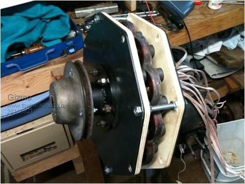

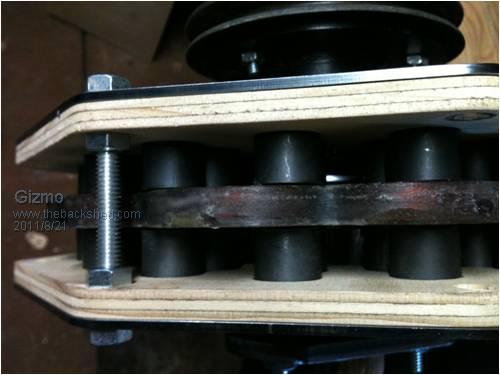

Some pictures of the alternator.

This project of you's is really comeing together. I'm impressed with the tight tolerances of the magnet to rotor clearances. The prediction of the voltage/amperage was spot on. This should be a "old realible mill" for several years to come, and probably a granddaddy of many more to be built like this in the future. Keep up the good work.

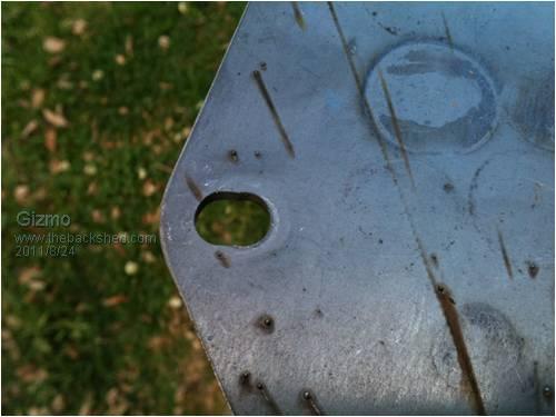

Posted: 12:02am 24 Aug 2011

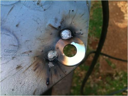

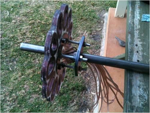

More work done. Because I had to widen the stator slightly, I needed to move the magnet spacing bolts further out from center, so I elongated the bolt holes with a file.
And then tac welded some washers to position the bolts correctly.

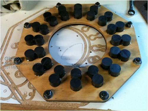

I painted the plywood magnet positioning plates in epoxy to seal them from the weather.
A fully assembled and glued magnet plate.

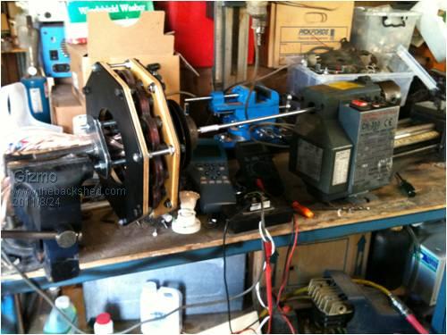

Now onto the testing. First I tried a belt drive from my little hobby lathe, but as soon as I loaded up the alternator the belt would slip, so changed over to a direct drive.
Unfortunately my little lathe just hasn't got enough low down grunt to spin the loaded alternator much over 350rpm, and its minimum speed is about 220rpm, above the alternators cut in speed
I've managed to get a few figures. Using a 12v battery as the load, with the alternator wired for 12v, star. Cut in would be about 170rpm. At 325rpm I get 44watts. Wired for 24v in delta, cut in would be around 140rpm, I get 57 watts at 325rpm. I need to try 12v delta, cut in would be higher but the watts would increase quickly compared to star above that speed.
Plotting a few points on a graph, I'm guessing at 120w at 500rpm for 12v star, 150w at 500rpm for 24v delta, again on a 12v load.
Looking further up the graph, 300 watts is achieved at 700 to 800 rpm. Too high for a direct drive, but using a 1:2 chain/gear drive it would suit a 2 to 3 meter turbine at 350-400 rpm. But thats just guessing, I need to do more tests. My milling machine has a bigger motor and better low speed torque, so I'll see if I can rig it up to test the alternator at higher speed.
Coil resistance ended up at 0.6 ohms per coil. 12v star ( with a series parallel configuration ) gives a phase resistance of 1.2 ohms.
