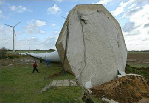

Posted: 09:20am 30 Nov 2009
I found this lurking in the depths of my computer.
It an article on calculating blade efficiency and may offer some ideas.
I dont know the source i got it from or the creditability of the information.
Perry, you are what i mean by the "clever minds" here. Thanks for the time and information you have given.
2009-11-30_191311_Factors_to_consider_when_evalutating_small _wind_generators….pdf
No matter how well you design something, the wind is a powerfull beast.
There is always the unexpected.
WHOOPS!
Pete.
