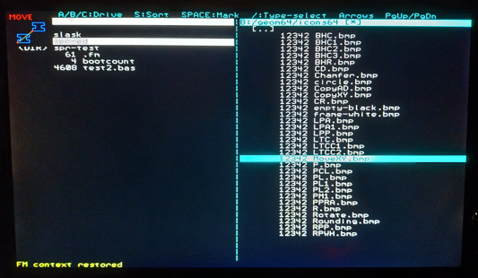

Posted: 02:10pm 16 Apr 2026
FM-notes from me...
I went through a number of "my own ICON files" in BMP format, all files the same size. But at the 33rd one that I was going to look at, it gives Error: Not enough memory. I close FM and start it up again. Tried doing the same thing again, at the 33rd one it gives Error: Not enough memory. Not a big deal for me, just a note from me...
Using FM, as I go through a number of ICON files, size 12342 bytes (attaching one file here). I press Enter and the BMP file is displayed perfectly OK, but when I look at it for the 33rd time, it becomes Error...
MoveXY.zip
/Peter63

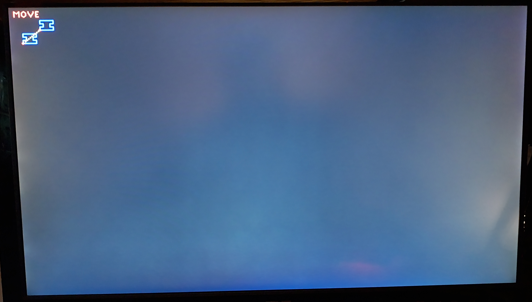

Posted: 09:14pm 16 Apr 2026
Note I made when using FM
Starting up FM shows a BMP file with Enter press everything OK.
I close FM, switch mode to > MODE 3
start FM again, and show the BMP file again, then it looks like this, the BMP file is displayed with FM in the background
/Peter63
