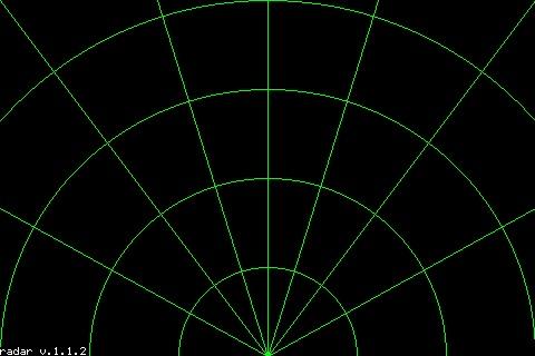

Ok. I had some 2mm female header. Soldered it on to a 2.54m female header after bending pins on both, and plugged that into the white connector on the HLK-LD2450. I plugged it into a USB-serial module, plugged it into my PC, set the baud rate at 256000, and could see characters. Mostly not printable ASCII.
I plugged it in to a Pico1 with latest firmware and ILI9488 LCD, downloaded the .bas file from Radar_v.1.1.2-blit.zip, set the serial port (double checked pin # and Rx/Tx, but could be wrong), and got this:
So that's a good start, but I have no dot, so 2 questions:
How should I determine whether I'm getting serial input, and
Where do I make changes for the ILI9488 480x320 LCD?

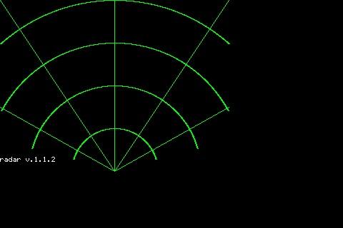

Posted: 08:32pm 09 Dec 2025

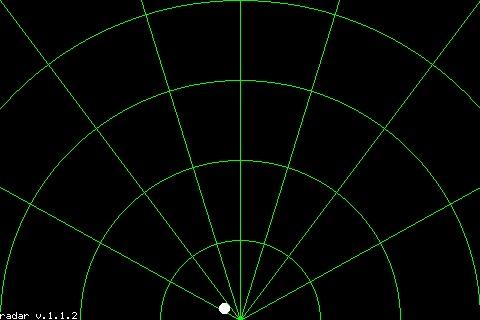

Try this
 ARC MM.HRES/2,MM.VRES,60,,285,75,RGB(GREEN)
 ARC MM.HRES/2,MM.VRES,120,,285,75,RGB(GREEN)
 ARC MM.HRES/2,MM.VRES,180,,298,62,RGB(GREEN)
 ARC MM.HRES/2,MM.VRES,240,,318,42,RGB(GREEN)
 LINE 0,0,MM.HRES/2,MM.VRES,,RGB(GREEN)
 LINE MM.HRES/2,0,MM.HRES/2,MM.VRES,,RGB(GREEN)
 LINE MM.HRES,0,MM.HRES/2,MM.VRES,,RGB(GREEN)
 LINE 0,150,MM.HRES/2,MM.VRES,,RGB(GREEN)
 LINE MM.HRES,150,MM.HRES/2,MM.VRES,,RGB(GREEN)
The target should appear after it sees movement. Wave a hand in front should be enough.

Posted: 01:57am 10 Dec 2025
Beautiful screen now with Radar_v.1.1.2-blit-2.bas.
But still no dot. I swapped Rx & Tx just in case, but no difference. Tomorrow I'll hook up those Rx & Tx pins from the PicoMite through a USB-serial module to confirm whether I've got them right.
BTW, "H", "P", and "Z" did not result in any output.
Are the arcs at any predictable distance from the module?

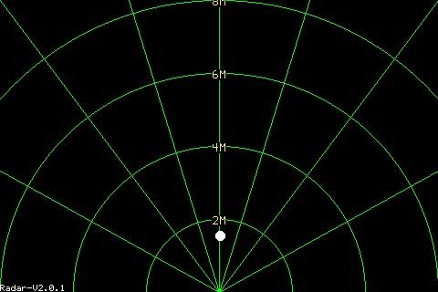

Posted: 07:55pm 11 Dec 2025
Working now, thanks, all. The pin labelled "0V" on my PCB was not actually connected to 0V.
This will be fun to play with. I'd like to map it to the area around my shed. How far out does it range, and any suggestions as to how to label the arc distances from the module--perhaps at the intersection of each arc with the line which goes to the upper right corner?
(Sorry to be asking these questions, when I could investigate. AI has me spoiled for asking questions. Nice also to have some non-artificial intelligence to query.)
Edited 2025-12-12 06:30 by lizby

Lizby,
no need to interrogate AI, this is natural NI (No Intelligence) answering
- as I wrote, a good GND connection is always your friend (had that already myself several times)
- the max range of the sensor is 8000 mm as of the datasheet. It certainly also depends on the size of the target how far the actual range will be.
- the attached V2.0.1 has now distance labels. You can modify the parameters as you like. They are at line 101 onwards, please read the comments. But labeling in feet and inches may be a bit of a challenge ... at least for me as a metric guy.
