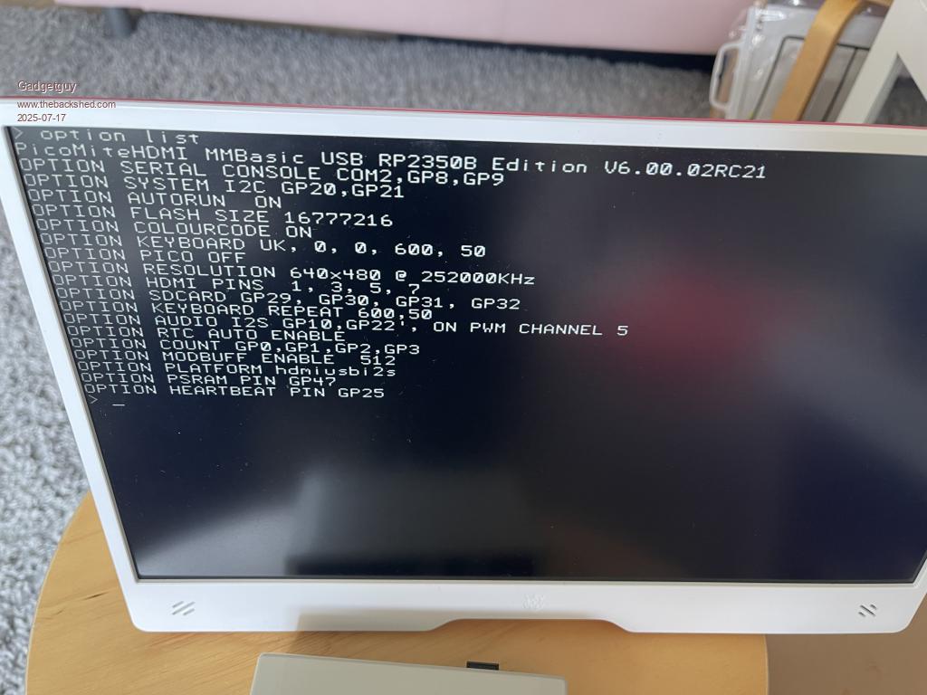

  Gadgetguy said  Hello all, I have a "newbie" moment - sorry for that. I have just updated my Picomite with the most recent USB HDMI 2350 firmware (file name PicoMiteHDMIUSBV6.00.03.uf2)
After doing so my HDMI out does not work any more (tried two different monitors) - while it worked before the update.
I am able to log into the box via serial and it seems fine (as far as I can see).
What am I doing wrong here please?
Thank you for any pointers.
Update: I have entered OPTION RESET HDMIUSB -> still no HDMI
I do not see the breathing LED - I see two green leds and a red led on

  matherp said  Tell us what H/W platform you are using. Try clearing flash before re-loading the firmware.
I use the "reference design", purchased from Phil.
The previous firmware was (if I remember well) a v6 rcxx (maybe 24?)
I tried clearing the flash (by using the Clear_FlashRP2350.uf2 file)
And it seems the system does not see my SD card either.
When I do b:
Then files
I get no SD card error.
Thank you so much for trying to help, I very much appreciate it.
I do not have my previous option list I am afraid...

This is what I see now:
PicoMiteHDMI MMBasic USB RP2350B Edition V6.00.03
Copyright 2011-2025 Geoff Graham
Copyright 2016-2025 Peter Mather
> USB Mouse Connected on channel 2
> US USB Keyboard Connected on channel 1
> option list
OPTION SYSTEM I2C GP20,GP21
OPTION FLASH SIZE 16777216
OPTION COLOURCODE ON
OPTION KEYBOARD US
OPTION PICO OFF
OPTION RESOLUTION 640x480 @ 315000KHz
OPTION SDCARD GP22, GP26, GP27, GP28
OPTION AUDIO GP10,GP11', ON PWM CHANNEL 5
OPTION RTC AUTO ENABLE
OPTION MODBUFF ENABLE  192
OPTION PLATFORM HDMIUSB
> b:
> files
Error : SD Card not found
Gadgetguy
Joined: 26/04/2025
Posts: 104
Posted: 01:03pm 17 Jul 2025
Hello all, I found it.
I had from Phil a screenshot of how my options should look like.
I did OPTION RESET
Then started to enter the original options - and it seems to work
For next time I will have to remember this.
Sorry for wasting your time

Gadgetguy
Joined: 26/04/2025
Posts: 104
Posted: 01:49pm 17 Jul 2025
  matherp said  The correct configuration for that board is:
OPTION RESET HDMIUSBI2S
Thank you!!!!!
