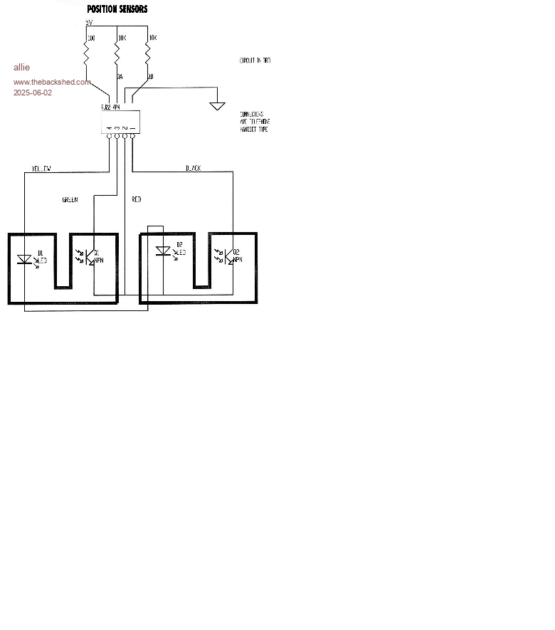

  PhenixRising said  I seem to remember going through this before. If the physical line count is 100, you get *4 multiplication with quadrature decode.
I just tried the maximum full count that the y axis can move which is 7" and the count was 14,001 so that's *2 multiplication. May be my sensors are not quadrature decode.
Some one seen the picture that I posted last year and told me it was. I'll post it again.
Is this encoder quadrature
regards Allie
Edited 2025-06-02 00:25 by allie

Makes no sense. The diagram shows the phase offset and the quad decode responds to all four transitions. Something doesn't add up.
Do you have a spec sheet for the encoder?

I searched the DRO encoder on the web and I couldn't find any specs, so I counted the
teeth on the wheel that turns in between the two sensors and it has 25 teeth on it.
where there is 25 teeth and 2 sensors shouldn't the count be 50/1000 instead of 100/1000.
Allie
Posts: 3429
Posted: 10:30pm 01 Jun 2025
Now we are getting somewhere. you can get 2 counts per tooth with leading and trailing edges. The 90° offset between sensors (from the perspective of a tooth, not the wheel) gives a total 4 counts per tooth.
In the motor specifications "Stepper Motor 100 oz-in, 2 Amp, #23 Frame size, 400 steps per revolution" they are probably talking about the same kind of steps. That is each phase probably has 100 poles, which does not match the 25 you found on the encoders.
If the motors have 100 poles / phase your encoders then only have 1/4 of the specified resolution, reducing their usefulness.
Recording both phases from the motor drive will give the same quadrature signal as the encoders but with 4 times the pulse count per inch.
Posts: 6253
Posted: 06:02am 02 Jun 2025
Yes, that looks like 25 teeth...
In essence your motors have more resolution than the encoders. Depends on what you are trying to achieve that encoders may not be useful for accuracy in CNC, but can be used to detect of an axis is stuck.
