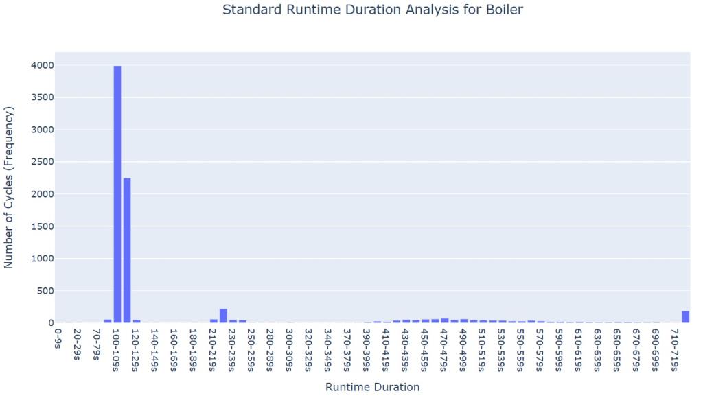

For the boiler, there are a lot of cycles between 100 and 120 seconds, and then some dozens in the range from 400 to 600 seconds.

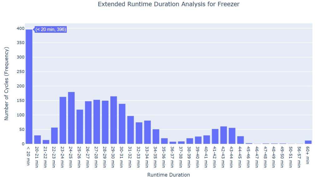

And the freezer: 396 cycles under 20 minutes, but over 1,000 between 20 and 45.

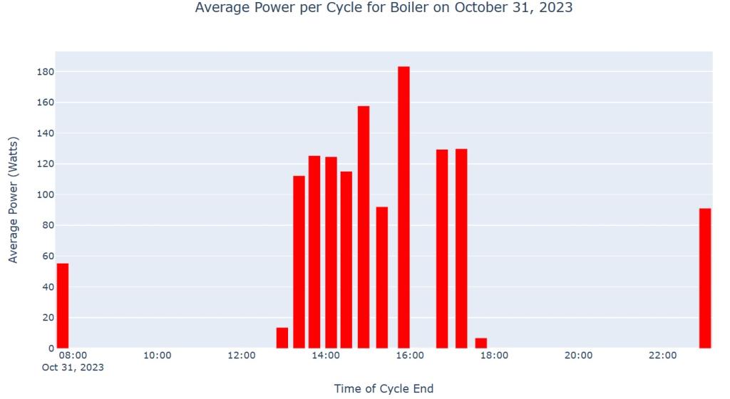

The other important factor that can be derived from my data set is average power for each cycle (exclusive of the inrush current). I asked it to chart that for any specified day by taking the milliwatt hours of each cycle, multiplying it by 60, and dividing it by the duration of the cycle. This gives the wattage at which it is running to have used the watt-hours it reports.
Here it is for the boiler on October 31, 2023 (the day of most usage for that month); maximum of a little over 180 watts:

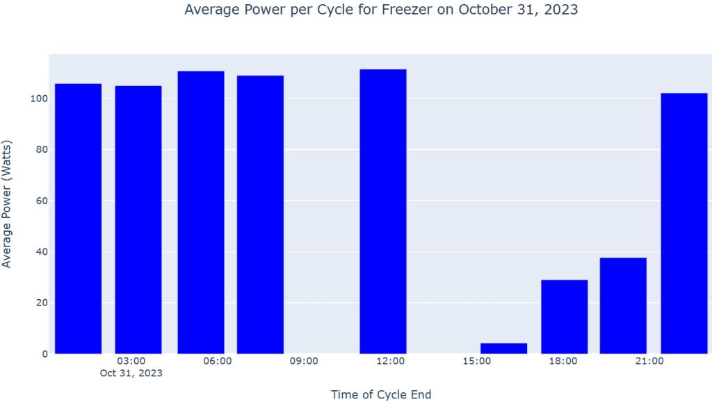

And the freezer, with maximum of 111 watts:

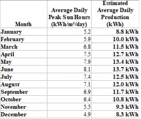

The first question I asked Gemini was about average daily insolation per month for Santa Fe, New Mexico (which would have similar insolation). It knew where to look, and after several of those mindless reversions, gave me this table for a 2.2kW system:

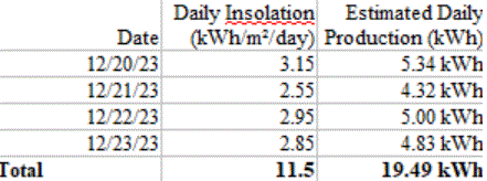

Well and good. On average, a 2.2kW system would produce between 8 and 13kWh per day. I then asked it to discover the production for the 4 worst consecutive days for insolation in 2023. After much more completely wrongheaded struggle, Gemini came up with this:
An average of 4.7kWh per day. If you used a quarter of the 10kWh battery each day, you'd have about 7.5kWh per day to spend. If you had a 1K gasoline generator, you could match your full average production.
The good thing about the session, was that Gemini knew where to look for the local insolation data, the National Solar Radiation Database NRSDB https://nsrdb.nrel.gov/data-viewer, and it knew how to use the API to drill into that database.
I trust that this serious issue of completely disregarding the prompt will be fixed in a later version. Meanwhile, I may subscribe to ChatGPT if Gemini persists with this cluelessness which you wouldn't tolerate in an employee.
