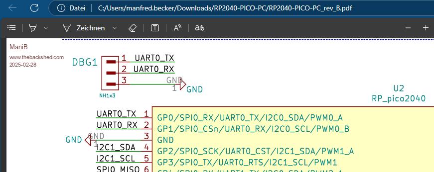

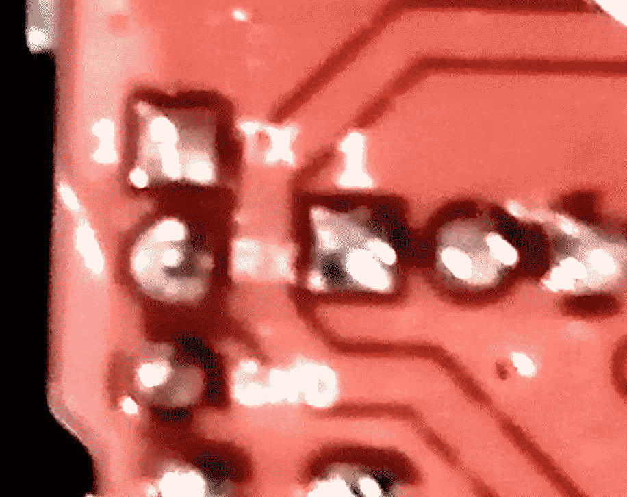

Martin H.
Joined: 04/06/2022
Posts: 1579
Posted: 08:39am 28 Feb 2025
  matherp said  Use OPTION RESET OLIMEXUSB and connect to the serial port header next to the USB
Found it, thank you Peter.
Unfortunately, the Olimexboard did not include a description or circuit diagram, hence the question

Posted: 08:56am 28 Feb 2025
  Martin H. said  Unfortunately, the Olimexboard did not include a description or circuit diagram
Which board is it?
Usually they provide both :)
ManiB
Joined: 12/10/2019
Posts: 193
Posted: 09:38am 28 Feb 2025
It is also shown in the schematic:

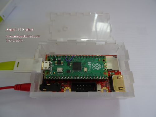

4. Where do you come from? I lasered this housing at FabLab here. I may still be able to get hold of the data:
Frank

  Xian said  I am living a bit south to Münster - from your nickname i assume you're close to the river Main.
Not really! I live near Nuremberg.
  Xian said  If you could send the data for the case, that would be very kind.
It will take a little while. I have to contact someone first (I should have taken the data with me when I helped design the housing...). I would also like to have a few of the housings laser cut again.
