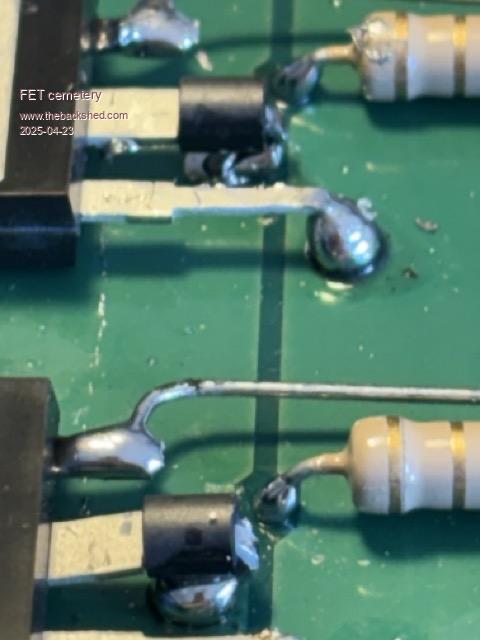

Hmm kind of committed now, the heatsink is marked and I've started drilling. Will change my mind if it gets messy!
Soldering the drains is possible, just not pretty.

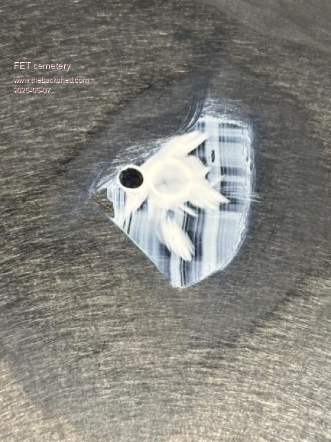

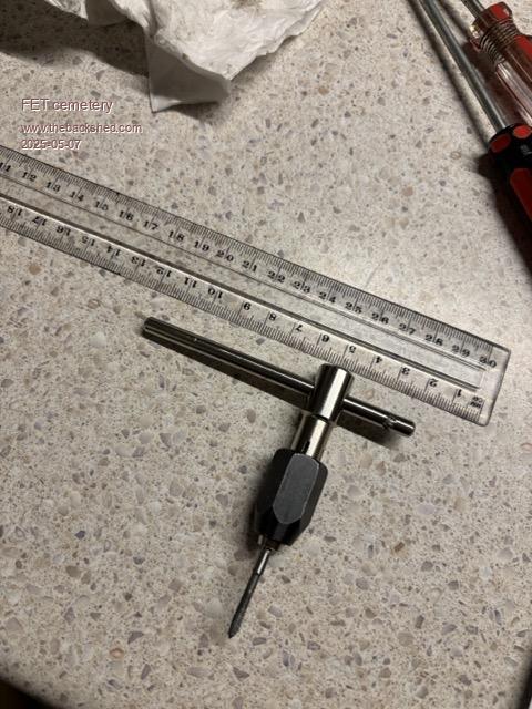

OK, I've recovered from the transcendent meditative bliss of drilling and thread tapping, went pretty well really, only broke one drill bit early in the piece.
My drill press won't hold a 2.5 mm bit so I tried drilling with the cordless drill. Murphy's friend is right, a drill press is necessary for this, got a drill bit with a hex bit on the end (meant for an impact driver) and used that in the drill press and no further problems. Slow and steady wins the race here.
Tapping just needs patience and a bit of light oil. A small tap holder so you can feel what's going on helps. I used a tapered tap, 1 1/2 turns in then 1 turn back and take it all the way out and clean it as soon as you feel it tighten up.
The way my heatsinks were originally drilled meant there was no way of having all the fets clear of the existing holes. To fix this I put some thermal paste on a screw, tightened it firmly into the hole and cut it off with a dremel. Ground it down just below the level of the heatsink and filled the gap with some thermal paste before sticking on the insulating thermal mat.

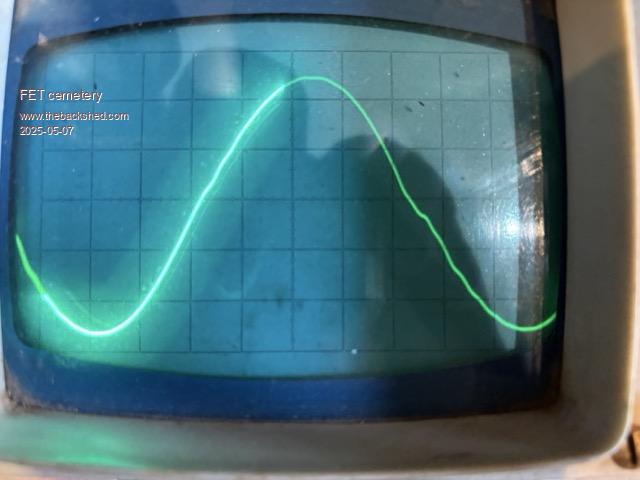

Started testing today using the big transformer and something is clearly not right.
I don't have a proper current limited power supply so I've been using 18V cordless drill batteries with an automotive tail light globe in series as a current limiter.
At 18V unloaded all seems well, a good enough sine wave on the scope and about 600mA idle current.
At 36V the transformer has a noticeable hum and the sine wave is starting to look a bit gnarly.
At 54V the pwm is down to about 70% but the hum is still there and the sine wave is not great:
This was all with 2x 470uF capacitors on the power board, the 2 chokes with 4 turns through 8 sendust rings each and 4.7uF across the transformer output.

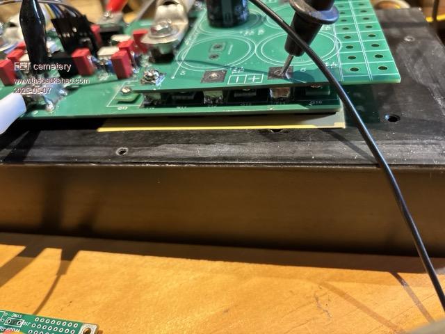

I'm thinking it has to be one of the bias supplies or something downstream of them. Wondering if I didn't cook one of the low side Zeners when I soldered them in.
Fets all check out ok with the meter, drain - source resistance 1M9 and a bit.
No stone unturned, no FET unburned.
Posts: 3421
Posted: 08:35am 07 May 2025
The drive to the primary needs to have perfect symmetry. Any difference between the half cycles produces a DC component**. Your primary circuit DC resistance may be just a few milliohms so even a small DC voltage can produce a large DC current pushing one half-cycle toward saturation, which increases the current on that half cycle even higher. This positive feedback can result in full saturation.
Magnetic amplifiers and saturable reactors work on this principle.
A DC ammeter in series with the primary will show if this is the problem.

FET cemetery
Joined: 17/04/2024
Posts: 77
Posted: 08:52am 07 May 2025
Thanks Phil will check it.

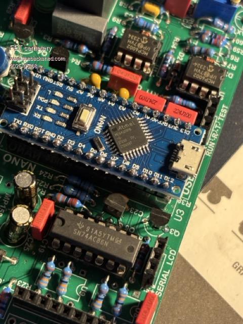

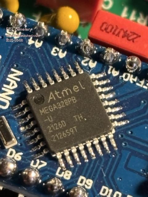

Could it be dodgy nanos? The Atmel logo looks a bit suss.

Posted: 07:35am 08 May 2025
  Quote  Could it be dodgy nanos? The Atmel logo looks a bit suss.
I had the exact same nano's with the micro usb, they run fine in the inverter , I just had issues with the USB on the old computer, So I ended up using them for running the LCD, you can try other Nano's if you have some, But I think something else is a bit off, will have a look later.
I have also an Electrolytic for C10.
