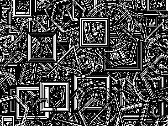

Black and White Infinite Art Cubism
MODE 1
 Q=Int(Rnd*5+3): If Q=7 Then Q=30
 A=Rad(360/Q): S=Sin(A): C=Cos(A)
 X=Rnd*MM.HRes: Y=Rnd*MM.VRes
 R=Rnd*(Sqr(Y+X)/20)*40+16
 For L=-R/5 To R/5
   N=(Abs(L)<R/8)*Int(Rnd*2)
   U=R+L: V=U
   X1=X+U: Y1=Y+V
   For I=1 To Q
     T=V*C-U*S: U=V*S+U*C: V=T
     X2=X+U: Y2=Y+V
     Line X1,Y1,X2,Y2,,N
     X1=X2: Y1=Y2
   Next
 Next
Loop While Inkey$=""

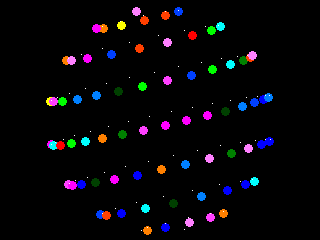

3D DISCO BALL
MODE 2
FRAMEBUFFER CREATE
FRAMEBUFFER WRITE F
 CLS
 t=Timer
 n=7
 r=n*16
 tr=t-n*50
 ra=tr/1234
 rb=tr/2345
 For a=0 To Pi Step .39268
   For b=0 To Pi*2 Step .8-.6*Sin(a)
     o=Sin(a)*Cos(b)
     k=Sin(a)*Sin(b)
     e=Cos(a)*Cos(ra)+k*Sin(ra)
     x=(o*Cos(rb)+e*Sin(rb))*r+160
     y=(e*Cos(rb)-o*Sin(rb))*r+120
     If Cos(a)*Sin(ra)-k*Cos(ra)<.05 Then
       C=Map(Int(Rnd*14)+1)
       Circle x,y,4,,,C,C
     Else
       Circle x,y,1,,,Map(15)
     EndIf
   Next b
 Next a
 FRAMEBUFFER COPY F,N,B
Edited 2024-11-27 04:25 by javavi

3d disco ball rotataing x axis and y axis same time?? maybe?
javavi
Joined: 01/10/2023
Location: Ukraine
Posts: 636
Posted: 07:38pm 28 Nov 2024
  stanleyella said  3d disco ball rotataing x axis and y axis same time?? maybe?
Yes, its axis rotates in three directions, but the ball itself does not spin.
Don't you have anything to see this on?

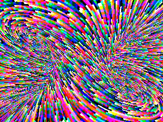

Attracting Star Whirlpool
MODE 2
Dim integer cm(15)=(0,14,0,7,0,0,6,0,0,4,0,0,2,0,0,0)
Colour Map cm(),cm()
Q=.375
For E=1 To 40 Step .025
 R=E*E/4:T=R/99
 s1=Sin(T):c1=Cos(T)
 N=5+R/1:A=-Pi*2/N
 S=Sin(A):C=Cos(A)
 X=0:Y=R:I=Rnd
 For L=0 To N
   I=I+1 And 15: If I=0 Then I=1
   Color Map(I)
   Pixel 160+X*c1*Q-Y*s1,120+X*s1*Q+Y*c1
   x1=X*C-Y*S:Y=X*S+Y*C:X=x1
 Next
Next
 T=cm(1)
 For i=1 To 15-1:cm(i)=cm(i+1):Next
 cm(15)=T
 For i=1 To 15:Map(i)=cm(i):Next
 Map Set
 Pause 50
Loop
Gratitude:  matherp, Martin H., stanleyella
Edited 2024-12-01 01:40 by javavi

nice one javavi
make it go in reverse maybe?

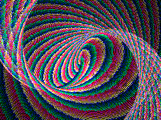

  stanleyella said  nice one javavi
MODE 2
Dim integer cm(15)=(0,1,2,3,4,5,6,7,8,9,10,11,12,13,14,15)
Q=.375
R=E*E/4:T=R/99
s1=Sin(T):c1=Cos(T)
N=5+R/1:A=-Pi*2/N
S=Sin(A):C=Cos(A)
X=0:Y=R:I=Int(Rnd)
For L=0 To N
  Color Map(I)
Next
Next
T=cm(15)
For i=15 To 1+1 Step -1:cm(i)=cm(i-1):Next
cm(1)=T
Map Set
Pause 50
Loop
Edited 2024-12-01 06:11 by javavi

nice! is pico and mmbasic brill?
looks like star trek ds9 wormhole :)
