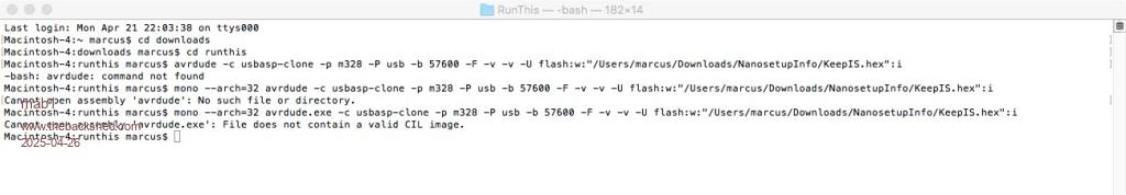

OK, I followed your 1st instruction first from the open Terminal window - i hope that is what you intended,rather than running it from within avrdudess? (various attempts to make it work):-
then using the files in your zip:-
doesn't seem to run, although i thought it did run from within avrdudess.

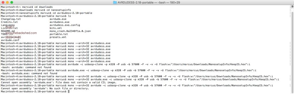

Edit:
I'm just wondering: because i have to run avrdudess within 'mono' .net framework thingy, is the problem actually that mono doesn't allow access to usb ports? not that that gets me any closer
Edited 2025-04-26 07:41 by mab1

OK, had a though about what you were saying that averdude must run on the mac (without mono) for the IDE to function, so looked for the command line in the previously posted IDE attempt to use the USBasp:-
/Users/marcus/Downloads/Arduino.app/Contents/Java/hardware/tools/avr/bin/avrdude -C/Users/marcus/Downloads/Arduino.app/Contents/Java/hardware/tools/avr/etc/avrdude.conf -v -p atmega328p -c usbasp -P usb -U flash:w:/var/folders/2s/n4lnvcqs55g0zlsbjg2tlsl80000gp/T/arduino_build_174515/Blink.ino.hex:i
so what happens if i graft in the path to the .hex file we want:-
/Users/marcus/Downloads/Arduino.app/Contents/Java/hardware/tools/avr/bin/avrdude -C/Users/marcus/Downloads/Arduino.app/Contents/Java/hardware/tools/avr/etc/avrdude.conf -v -p atmega328p -c usbasp -P usb -U flash:w:/Users/marcus/Downloads/NanosetupInfo/KeepIS.hex:i
paste that into Terminal and:-
Macintosh-4:~ marcus$ /Users/marcus/Downloads/Arduino.app/Contents/Java/hardware/tools/avr/bin/avrdude -C/Users/marcus/Downloads/Arduino.app/Contents/Java/hardware/tools/avr/etc/avrdude.conf -v -p atmega328p -c usbasp -P usb -U flash:w:/Users/marcus/Downloads/NanosetupInfo/KeepIS.hex:i

Just got to the computer, the terminology is throwing me slightly.
The text I sent is a command line argument that is passed to avrdude to process and run.
For this to happen, and this is where I have no idea what the iMac OS limitation is in this case, I will tell you what is meant to happen.
In Windows, you would place the 3 files I zipped into a directory, you would then open a command line window, and copy the command from RunThis.txt into the command window and press enter.
avrdude.exe (which is inside the directory) will run, I don't have to tell the OS where avrdude.exe is located, it assumes that it's in the current directory, avrdude will run and will look first in the current director that it launched from for the config file and process the entered command line argument.
Also in windows, you could rename the file "RunThis.txt" to RunThis.bat and simply run it, the .BAT extension (batch file), automatically passes the command to the command interpreter.
Without knowing how your OS processes a command or the structure of the command or the registration of programs to the OS makes it difficult.
What I was trying to do was to remove the GUI interface program called AveDudess from the process, as it having trouble finding the programmer - IE it's not working correctly, but we have already proved that the command line program avrdude.exe can work.

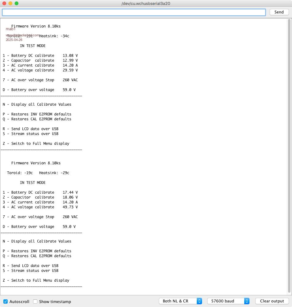

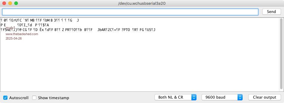

Umm...is it ? to get the menu?
I get this as a response:
Edit:
Wrong baud rate!
edit:
actually,  feels a bit tame - i feel more like:
Edited 2025-04-26 09:36 by mab1
KeepIS
Joined: 13/10/2014
Posts: 2287
Posted: 11:45pm 25 Apr 2025
So glad to see it going, Ideally, we should get the fuses set and the boot loader removed.
However you should be able to test the boards and it will run. Just have a look at the help file for how to use the Menu.
Basically, you don't press Enter at all, enter key is only used to accept a voltage or current value typed in if the Menu asks you to do that.
You also need Local Echo on in the terminal application to see the keys you press, the Nano Menu does not ECHO back your key strokes to the Terminal program.
IE without having local Echo on, you wont see anything you enter - it will look like the Nano is not responding to you

BTW the Menu display you posted was in Simple Menu mode, pressing Z will reveal the full menu.
