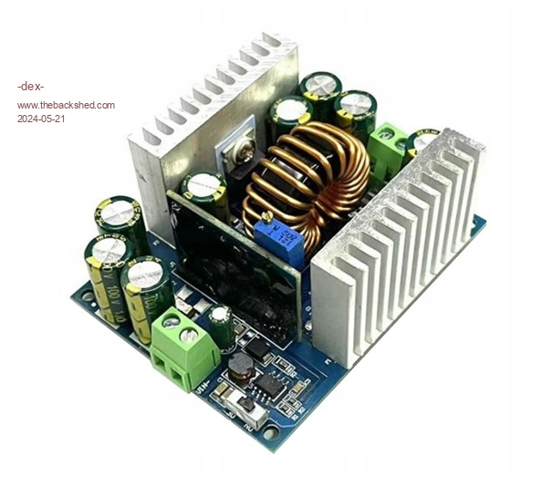

Small update about OVP mppt circuit. As I said earlier, I have a relay on the board that turns on/off the BAT-12V converter that powers all MPPTs. The converter has low ESR capacitors at the input, which stuck the relay together during one of the subsequent tests. So I'm making a small soft start circuit: a serial NTC thermistor, or a resistor + relay powered from the output.
Moreover, in this casing I placed a caps mppt pre-charging system - behind the kilovac relay, activated manually with a switch.

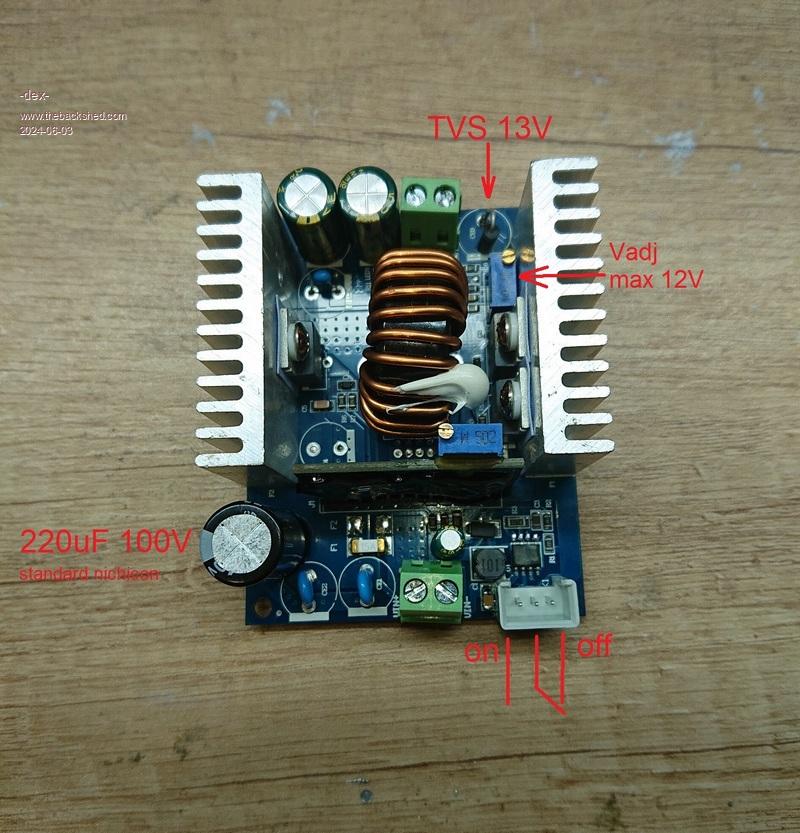

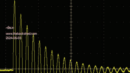

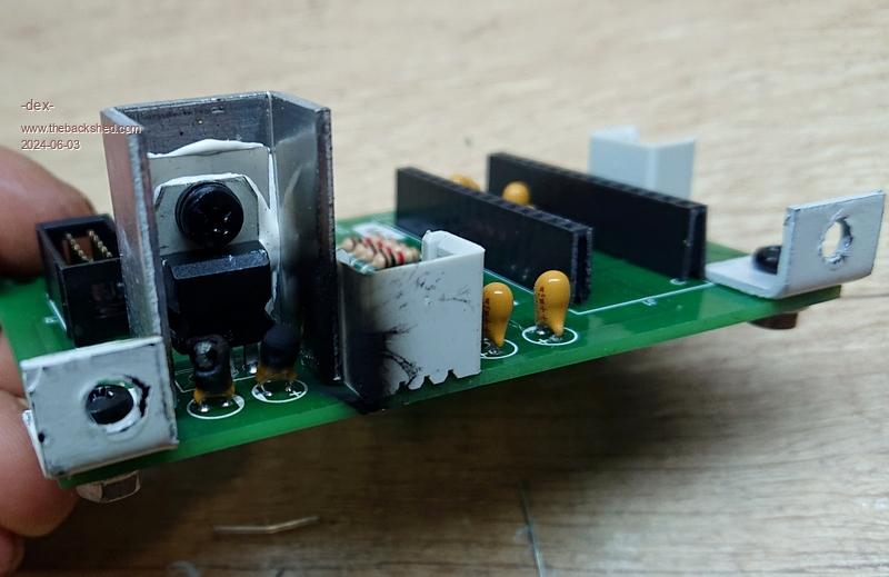

Next update to the above circuit.
I made a soft start of the DC converter, it is a 100R resistor in series, shorted by a relay powered from the output of the converter.
The problem with surge current and welded relay contacts, has been solved. Hopefully? This is way you should not do this way with this converter.
Since using this system, another problem appeared: after several successful starts, the next one caused one of the tlp250 and its isolation dc-dc converter (mppt pwr pcb) to burn out. They have been fixed. And again, a dozen or so correct starts, and the next time the capacitor (10uF 16V tant) at the oneof brainboards stabilizer was damaged. The explosions occurred exactly when the 12V converter was turned on. Why?
So I went back to this large common 12V converter and analyzed again what was wrong.
It looks like it's feedback system doesn't work fast.
First, my start-up circuit charges the caps through a resistor to a certain voltage that allows it to start, and then suddenly increases the voltage at the input by closing the charging resistor. There must be a short voltage spike at the output - some elements take over, others burn out.
Therefore, starting the converter must be done differently.
I changed the values ​​of some caps, and added a surge diode at the output.
The converter had an original on/off switch which has now been replaced with relay contacts (SPDT).
From now on, the MPPT ovp protection can safely turn on and off 12V PS for all MPPT chargers and the kilovac relay.
Yes, I confirm, tantalum caps do not like momentary voltage rises. 7805 IC survived.
