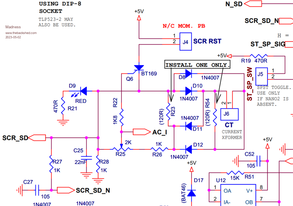

The SCR shutdown is part of the Nanverter control PCB, there is a 2000 turn current transformer on the AC output of the inverter. This circuit is connected to the Shut Down pins of the MOSFET driver ICs. If the AC current rises too far the SCR turns on the shutdown and the ICs turn off the MOSFETs instantly. It was the resetting of this and not expecting that the MOSFET drive signals to the driver ICs was still present that caused the hard restart, an not do a soft gradual startup as I was expecting.
Thanks for the clarification.  Looking at the nanoverter code, it appears to not monitor the SCR shutdown input at all much less doing any protective PWM shutdown.  No wonder the FET's blew.

I have not looked at the code as yet but I am not surprised with what you found. Now that I am aware of it, all I need to do is flick the switch to stop the SPWM output and then reset the current trip if it triggers. The time I have had available has been spent on assembling a new power PCB. All going well I will have it running today with just a few MOSFETs for testing. Also, I will see if the cable I have used for the chokes can be forced into another turn around the core.

Regarding Nano inverter shut down, I never quite understood the SCR method Poida uses.
Instead I'm using the old method Oztules came up with, modified so that overload & undervoltage turn off the nano's ON switch.
This works for me.

The Oztules SCR shutdown pulled the current feedback pin high on the EG8010, which shut down the SPWM as well as directly shutting down the driver IC's. So the when reset the EG8010 did a normal startup with soft start.
If you are running a standard Nanoverter PCB then Nano1's D6 pin is connected to the SCR shutdown circuit and the code you are using checks that pin every half cycle and stops if it is high. So there is no need to have it connected to the on/off switch, under voltage is in the code as well. That SCR part of the code is not in the early version that Poida wrote with the 2XSINE. Obviously, that is something that was added sometime later. I need to look more at the code, I was too busy just working on getting the back feeding working.
