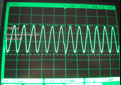

I was investigating the audio filter, as I promised, and noticed the audio tone does not play well. Please see below graph, there are 2 places where the sine wave is not continuous, but distorted. I excluded everything (i.e. SD card/system I2C).
Virgin VGA mite
MMBasic 05.07.05b11
OPTION AUDIO GP6,GP7
PLAY VOLUME 100,100
PLAY TONE 1000,1000
Software 05.07.04 (Geoff's official release) does not have this. Maybe it has some latency in stitching the waveforms together in the PWM. It is independent of the frequency. It may be (little) less in lower volume, but that may be due to oscilloscope triggering, missing these events.
They are not only visible on the scope, you can hear these distortions as short ticks in the audio. To the ear maybe a bit random. FYI in these tests I run the picomite without USB connection, so it is not the USB stack I guess...
It is better audible at 2kHz or 4kHz. If you think you get mad from the sine waves in your ear: PLAY STOP is your best friend...

  Volhout said  I was investigating the audio filter, as I promised, and noticed the audio tone does not play well. Please see below graph, there are 2 places where the sine wave is not continuous, but distorted. I excluded everything (i.e. SD card/system I2C).
Just injecting myself into the conversation here. I have also done some investigation into the audio quality using an oscilloscope. I too noticed some distortion, and the distortion gets exponentially worse as you go up in frequency. This is to be expected given the very rude/crude first order filter used to filter the output PWM signal. I noticed that above about 8 or 10kHz, a PWM sinewave no longer resembles anything like a sinewave anymore. This distortion is consistent across the entire waveform though, and not the same distortion that you are seeing. I suspect the waveform is probably becoming distorted when the PWM duty cycle is being updated perhaps.

  Quote  I noticed that above about 8 or 10kHz, a PWM sinewave no longer resembles anything like a sinewave anymore.
This would also be true if you played a 10Khz tone on a CD (4 samples per sinewave)
I will try and fix the bug Volhout has found but I'm not going any further than that on audio. However, I need a better low-pass filter to see the bug before I can see and fix it.
Volhout, can you confirm if the frequency stays correct when you see the glitch or is it a runt sinewave?
UPDATE: just realised my oscilloscope (Picoscope) has a programmable low pass filter. Using this I can't replicate the bug seen in Volhout's trace
Edited 2022-06-27 19:29 by matherp
Posts: 6254
Posted: 10:03am 27 Jun 2022
@Peter,
When the artefact happens the frequency of that particular since cycle is different (I measured a lower frequency, one I remember was 3.9kHz versus 4.2kHz for other cycles).
I estimate one PWM update is "late" and a sample is PWM-ed twice.
@Witenite
Yes, when the amount of "samples" per since cyle gets lower the odd harmonics increase. And for a 5kHz sine wave the 3'rd (15kHz) is within audio range and gets through UN-attenuated. So your sine wave doesn't look nice at all. For 8kHz, the 24kHz is in the filter falloff, and may get attenuated, but with only 5 samples per sine, the inaccuracy will be huge. 10kHz .... even worse.
When your goal is to get the nicest sine waves, then the low pass filter should drop of much earlier, and you have to live with an audio bandwidth of less than 10kHz. And that is not a curse. My transistor active filter has a really nice slope, and starts to rolloff at 10kHz. The 5 and 8kHz waveforms look nice, and it is very acceptable to listen to music (CD quality from SD card). But nothing above 10kHz.....

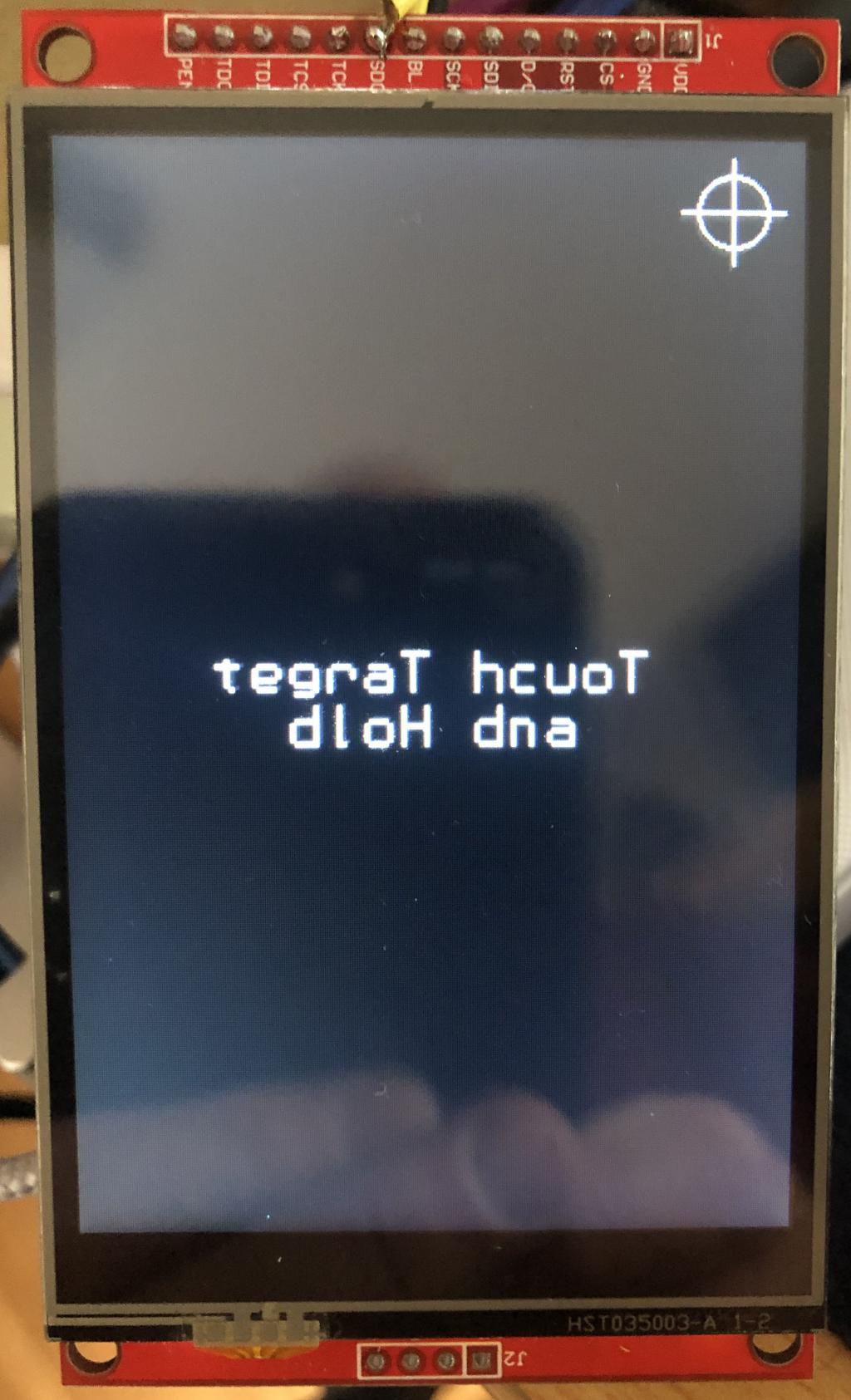

There appears to be a minor issue with that release Peter,
The 0,0 point is set for top right instead of Top left (at least with the ILI9481N driver)
It is probably my fault as I didnt notice that the test for MISO reads was colouring the pixels at the top right instead of top left. Well I did notice that was where the pixel was being set but it didnt click that it was the wrong corner.
Sorry about that
FYI these are my option settings:
OPTION AUTORUN ON
OPTION CPUSPEED (KHz) 125000
OPTION LCDPANEL ILI9481N, PORTRAIT,GP15,GP14,GP13,GP20
OPTION TOUCH GP12,GP11
GUI CALIBRATE 1, -167, 2043, 1267, -1737
OPTION SDCARD GP22
Posts: 12185
Posted: 07:14am 03 Jul 2022
Can you try all 4 orientations and let me know which are correct and which not - thanks
