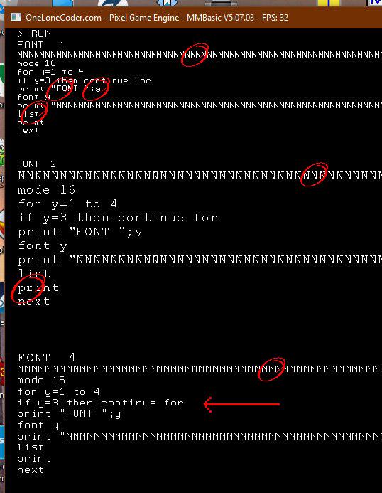

Matherp (or other gurus), I've had troubles running mode 16 - I get various corrupted characters on the screen. From what I've investigated, these corrupted characters are because the Window for MMB4W is not displaying a full 1920x1080 res and consequently the little bit of compression corrupts part of the screen. Mind you, the window fits exactly on my screen but MMB4W does not fill that window up (see left margin in the attached pic). Is this just my setup?
Posts: 12185
Posted: 10:07am 20 Feb 2022
  Quote  Is this just my setup?
Yes: sort of. You need a monitor resolution bigger than the mode you choose. My monitor is 4K and mode 16 works perfectly.
Goksteroo
Joined: 15/03/2021
Posts: 114
Posted: 10:26am 20 Feb 2022
Thought that might be the case - no biggy
Posts: 12185
Posted: 11:55am 20 Feb 2022
I can create a mechanism to go full screen which will solve it - I'll include that in the next release

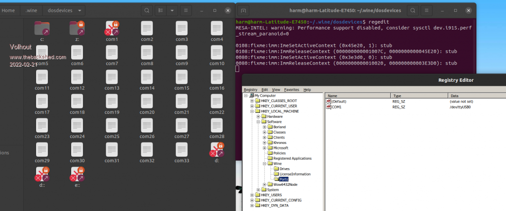

So how do we attach a USB serial port to MMB4W running under Wine...? All are attached to non existing hardware ports. Wine will add the /dev/ttyUSB0 after the first 32 hardware serial ports. so it will become COM33. When your program cannot handle COM33 (I expect MMB4W will, but some programs can not, they are restricted to COM1..COM4) then you need to force Wine to use the USB serial interface as COM1. This is how:
Regedit !
In the linux terminal, type regedit. You will start Wine's registry editor.
In HKEY_LOCAL_MACHINE/software/wine/ports you can find serial ports. This section is empty (only the default is there). When you add "COM1" with value "/dev/ttyUSB0" it will be replacing the default com1 link to /dev/ttyS0 to /dev/ttyUSB0.
See below picture that shows (in Ubuntu 20.04) the folder .win/dosdevices with many serial port links, and a link fopr the C drive. It shows the terminal where you start regeedit, and it shows an example in regedit, where I define the com1 link to /dev/ttyUSB0
For basic usage, when only 1 or 2 USB-serial interfaces are attached, this may suffice. You simply add a second entry in Regedit with com2 linking to /dev/ttyUSB1
For more complex setups, Linux can use rules, based on the manufacurer and serial number of the USB-serial convertor chip to identify each of them uniquely. When there is interest I can write a post about that.
So does it work .... YES
