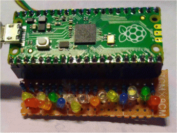

Here's a Picomite client accessed via serial (but otherwise following Geoff's example of the MX170 as an I2C slave in "A More Complex I2C Example" in the "Getting Started With the Micromite" guide).
I put LEDs on all the left side pins (I/O pins between the pin numbers 1 and 20).
Here's the picomite:
Here's a youtube video: Picomite serial client
Here's the master/server code running on MMB4W:
dim pins(16)=(1,2,4,5,6,7,9,10,11,12,14,15,16,17,19,20,0)
open "com11:115200" as #1
for i=0 to 15: print #1,chr$(1)+chr$(pins(i))+chr$(8)+chr$(13): pause 100: next i
for i=0 to 15: print #1,chr$(1)+chr$(pins(i))+chr$(0)+chr$(13): pause 100: next i
do:p=pins(fix(rnd*16)):v=fix(rnd*2):print #1,chr$(2)+chr$(p)+chr$(v)+chr$(13):pause 500: loop
The first FOR loop sets the pins as DOUT and the second FOR loop turns off all pins. The DO loop randomly selects a pin every half second and randomly sets it to on or off (1 or 0). No checking is done to determine whether the pin is already in the selected state.

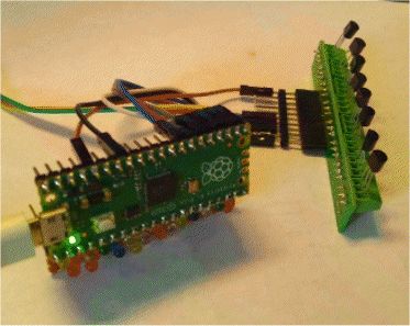

After some fiddling, this now gets readings from 4 DS18B20s on the client Picomite via serial:
dim integer i, p(4)=(0,24,25,26,27)
dim string s
font 1
for i=1 to 4:print #1,chr$(1)+chr$(p(i))+chr$(10)+chr$(13):pause 50:next
do
 for i=1 to 4
   print #1,chr$(3)+chr$(p(i))+chr$(10)+chr$(13):pause 100:line input #1,s: ?s
 next
 pause 2000
loop
