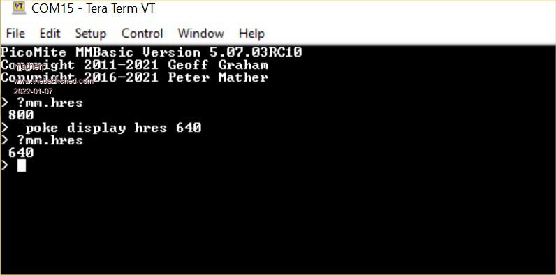

  matherp said
V5.07.03RC10
POKE DISPLAY HRES n
A litte bug in POKE DISPLAY HRES and VRES
The do set the HRES/VRES limits but also throw a syntax error:
PicoMite MMBasic Version 5.07.03RC10
Copyright 2011-2021 Geoff Graham
Copyright 2016-2021 Peter Mather
> ?mm.hres
800
> poke display hres 640
Error : Syntax
> ?mm.hres
640
Posted: 10:35pm 06 Jan 2022

Posted: 10:43pm 06 Jan 2022
fred777 - CR with LF perhaps
Posted: 10:45pm 06 Jan 2022
Try downloading again with clear cache. I did update the download, perhaps you got the earlier version

Posted: 09:36am 07 Jan 2022
  matherp said  I did update the download, perhaps you got the earlier version
Right, I really had the earlier RC10 version.
Works nicely now, thanks ever so much!
