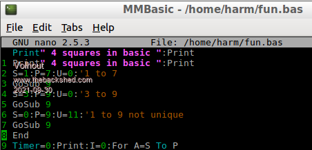

However saw 1 thing that intrigued.
Syntax highlighting is not perfect when line numbers are used...
When the line number is removed, highlighting works. See the top 2 lines of this basic listing. Also the second command on the line is not highlighted.
Maybe do not spend to much time on it. Nobody uses line numbers anymore...
