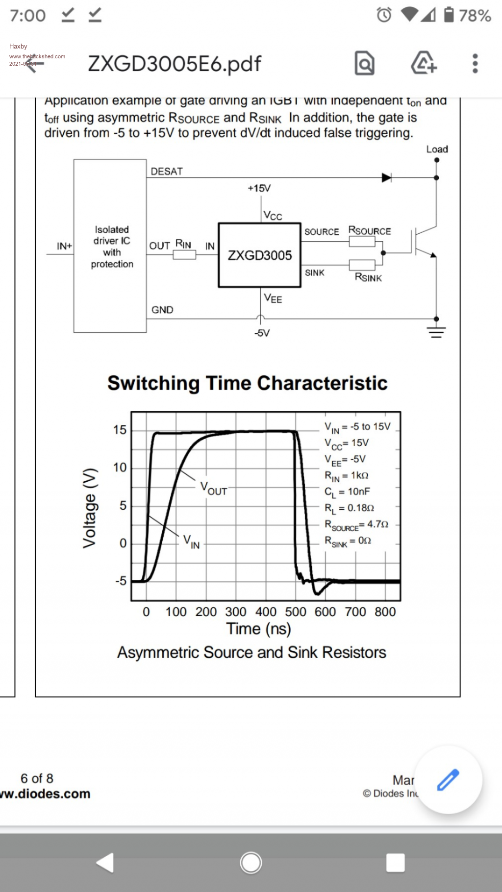

This is a great discussion guys.... I had a heap of problems driving my IGBTs and ended up "solving" the gate bounce issues with 82nf caps on the gates. Not an elegant solution.
I'm going to re-visit my solution based on the info I have picked up here. To save re-manufacturing some large PCBs I want to make up some very small piggyback boards to fit between the existing gate driver chips and the igbt gates.
The ZXGD3005 looks good. It's a totem pole 9A driver with separate source and sink pins. I think Solar Mike recommended them in another thread.
Wiseguy, do you suggest 4R7 resistors for both charging and discharging the gate?
What sort of inductor do you use for the gate lead?

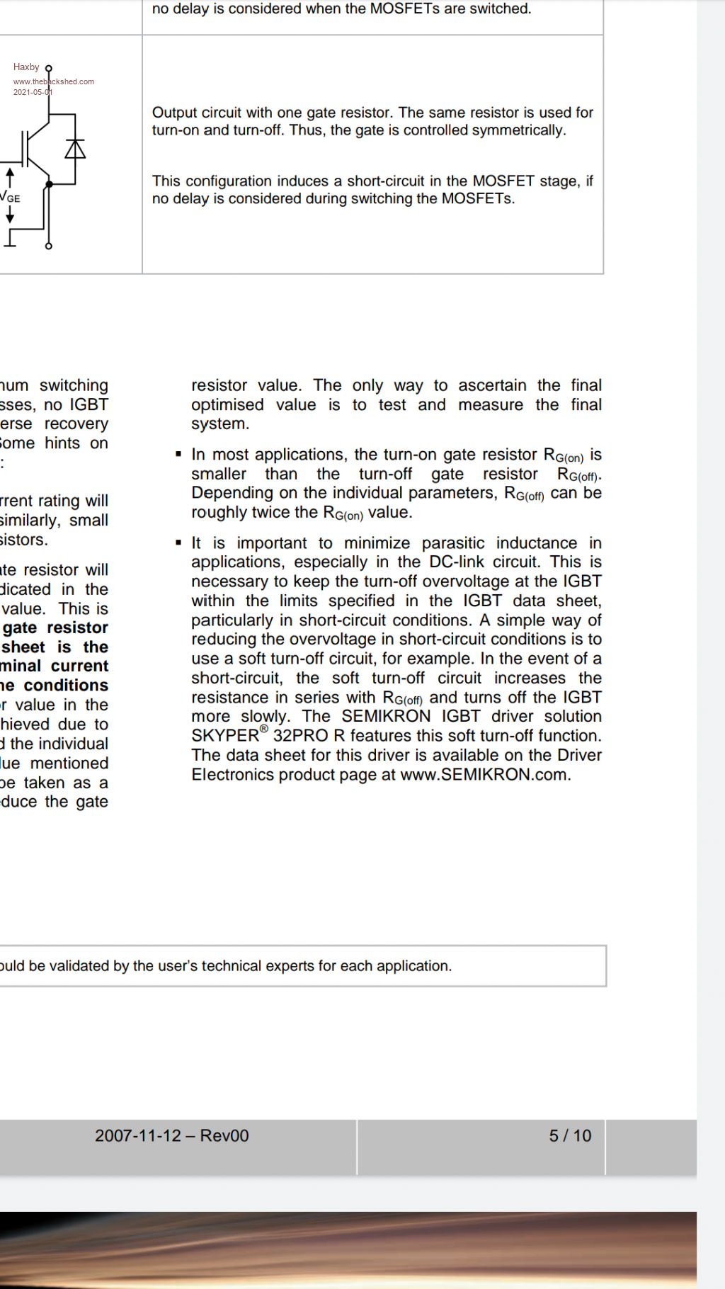

Haxby, I couldn't do a better job describing IGBT's than these 2 application notes I will link to:
App note 1)
Infineon-EiceDRIVER-Gate_resistor_for_power_devices-AN-v01_00-EN.pdf
App Note 2)
AN-7003_Gate_Resistor-Principles_and_Applications_rev00.pdf
Warp and Solar Mike have a lot more experience with IGBT's so I would rely on their help and the App notes to find your solution.
As you will see from the App notes larger gate resistors than MOSFET's use are common.
The problem and solutions we are discussing here are less relevant than with IGBTs they are a bit different when it comes to problems, causes and solutions.

Poida, if I was designing something like what you are describing, perhaps use these tiny SOT23-5 4 amp drivers, one per mosfet; common their inputs and drive from an opto isolated driver like the FOD3182 or similar. You can mount each within mm from the mosfet gate. A coincidence, I'm actually designing a pcb with 24 of them right now - UCC27519 non inverting, one per mosfet.
I have used the ZXGD3005 in the past but as they are emitter followers they don't switch rail to rail, the UCC27519 is the same size but with more options and perhaps better.

  wiseguy said  Haxby, I couldn't do a better job describing IGBT's than these 2 application notes I will link to:
App note 1)
App Note 2)
Wiseguy: that was a good read. Basically sums it all up nicely. Particularly the dv/dt and di/dt issues, which are amplified when switching higher voltages.
One thing that surprised me is in the second link it says that the "on" gate resistor is usually lower value than the "off" resistor. In my experience it is the opposite, though most designs I see refer to MOSFETs not IGBTs. Any insights on this?

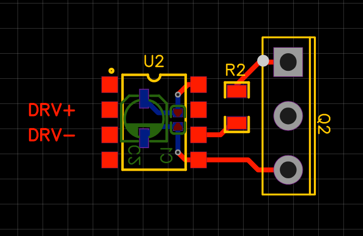

A compact layout could be like this:
isolated opto inputs
0 to +12V and -12V to +12V supply possible.
I intend to use jumpers to permit selection between the 2 drive options
short gate drive traces but can be built by me and my bad eyesight.

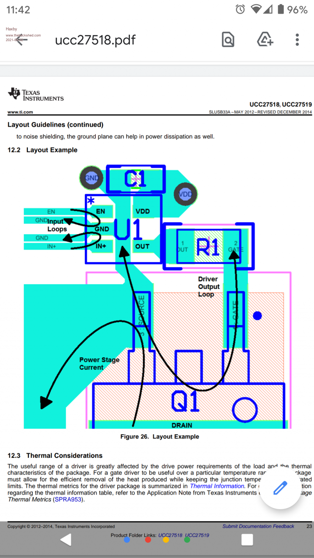

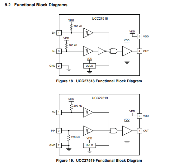

Double sided SMD boards will certainly scare away most hobbyists.
Here is the example layout of the ucc27518 Solar Mike referred to:
Single side loaded components and as big a tracks as you can afford

Poida what chip is that?
poida
Joined: 02/02/2017
Posts: 1507
Posted: 03:06am 02 May 2021
Haxby, it's the TLP350 in PDIP SMD package. Chosen at random.
Obviously better/smaller choices there.
I want isolated input signals so it's something like that
and not the UCC27519 even though this chip is tiny and allows tighter
loops.

That UCC5350MC looks like the answer to my particular prayers. The Miller clamp in particular will be invaluable.
Poida have you considered driving the gate negative?
The component count increases by 1 single zener diode and the choice of dc-dc converter could be changed to a 15v or even 24v type.
