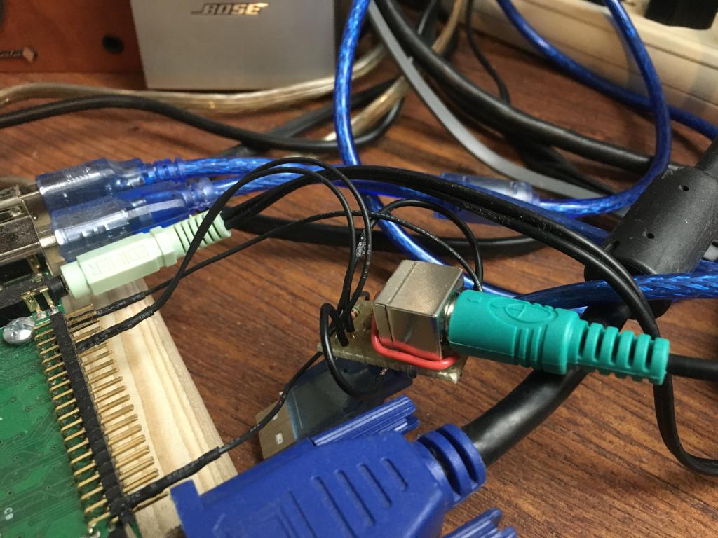

Well, after several hours of concentrated tinkering, my CMM2 has a new appendage!
I didn't prototype it, and went straight to soldering up the circuit with a "raw" PS/2 mouse jack and a couple of resistors, on a piece of copper-clad perf board. I can't believe how terrible my soldering skills have gotten!!
Much to my surprise, the thing worked first time, after a brief moment of panic before I reread Peter's original post and invoked the "OPTION MOUSE 0" command.
Works like a champ - file navigation and editing should be substantially more efficient from now on, and looking forward to using the new UI gestures in BASIC.
P.S. I drew up a "proper" circuit diagram -I'm pretty sure I transcribed my sketch correctly, but please let me know if I screwed it up.
