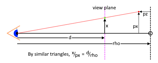

Since everyone likes pictures, here is (a version of) the geometry to project a 3-D point onto a viewing plane. Shown is for x, y is the same, as in my previous posting. You can see that as pz moves closer to the eye, x increases even if px stays the same, and vice versa. This is the basic premise of perspective.

Ughh, I made a mistake in the similar triangle equation.
It should be   x / px = d / (rho-pz)

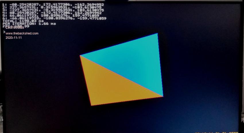

After some improvements and running using the RC5 firmware I reached 1198ms.
Probably I can improve my rotation algorithm to be more efficient.
I fixed an issue in my projection code and now the polygon is being cleared using a box with the dimensions shared by you (box 192,92,416,420,0,0,0).
The rotation directions are exactly as asked by Peter.

  Quote  ze = rho - pz    ' rho is distance from viewer to origin/object center
x  = d * px / ze ' d is distance from viewer to view plane
y  = d * py / ze ' (x,y) is projected point on view plane
I think this is wrong. You have to use the z position of each vertex individually to do the depth properly. Perhaps that is one reason why my version is so slow
It looks correct to me.  px, py, pz is the vertex point.  x,y is the viewplane coord for that vertex point.  You need to run through this formula for each vertex (px,py,pz), so 6 times in our case for the octohedron.

Posted: 10:54am 11 Nov 2020
  Quote  rho is distance from viewer to origin/object center
Perhaps just wording. This implied to me there was one Z distance for the whole "object" i.e. the tetrahedron

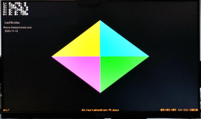

This is the polygon position (and size) before the rotation process.

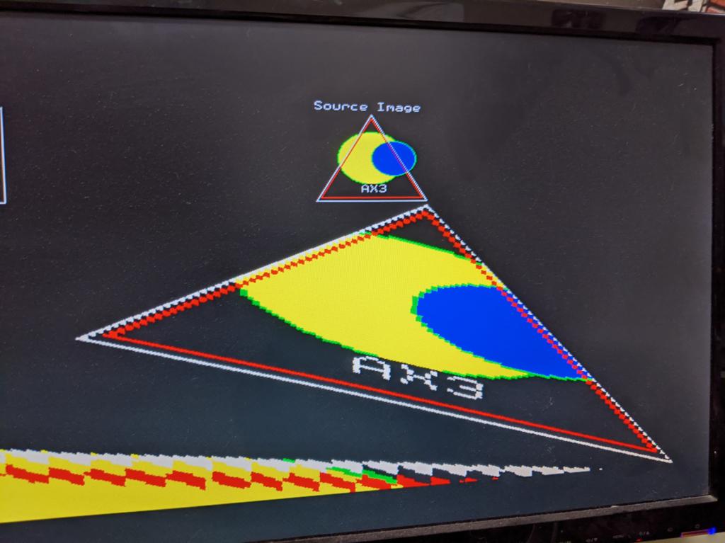

As per johnd's suggestion I'm thinking about how to do a generalised mapping of each pixel in an arbitrary convex quadrilateral onto the best fit pixel in a rectangle. I think this could also be very useful for the stuff Mauro is doing if it can be made efficient. I've got code already running that can iterate though each pixel in a quadrilateral. I need the most efficient algorithm to identify the best single pixel in a rectangle to copy.
I know you already have the skew code out there, but I've been working on this and am making progress. I've been reading through the required maths and to start with I'm building code that will read from a triangle (which in turn can be used to read from any shape including a rectangle). It works well, but still has some bugs and requires the triangle to be in a specific rotation. I'll fix these over the next few days and then throw the source code up here on the forum so that others can see if they can refine it. (Or if anyone else wants to have a crack at writing their own version from scratch?)
If it makes it in to the firmware that's great, but I won't be insulted if it doesn't make the cut. Once again, I'm just enjoying the programming challenge.

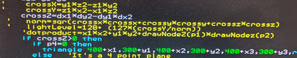

In my Elite code there is actually the remmed out code for the normal as I did tinker with changing the light level as vegipete suggested.
JohnD: Incidentally, when we are talking about calculating the cross product, I imagine we are all only calculating the Z of the 3D vector. This is enough to work out if the face is pointing towards or away from the viewer. The code for the other vectors is in the code blow, but that is also commented out.
