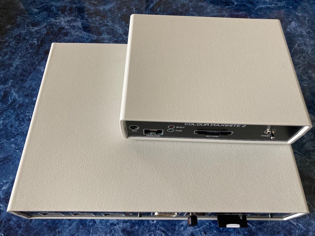

I have got the CMM2 deLuxe on Wednesday (ordered on Saturday), so I'm just putting here my experiences. In general I'm very satisfied with the buy. I will play with different FW for ESP, because this one is just for basic playing but is base for improvement. So here are my first impressions:
POSITIVE
• very fast shipping
• perfect packaging
• both USB A-B and A-A cables included
• SD card included
• Napoleon Commander serial communication works (python server needs change port name...)
NEUTRAL
• it didn't work with included A-B cable, picture is on the monitor, but keyboard not working (tried more sources, no change) - for me is neutral, because can be because of my enviroment
• tried 2 mouses, 1 works, 1 not
• WIFI firmware is really more for C64, but because in socket, can be easily flashed with something else
• SD card socket is different (not with spring) -just for info
• is VERY big compared to my other CMM2 (I didn't expect it)
Unfortunately I was not able to pack so much features in smaller case, giggest issues much more ports that are added comparing to original there is still some space to add more in distance feature, like HDMI. An there might be more to come...

Size is also OK and I understand the reasons, I was just surprised by difference. Maybe the size should be somewhere on you web.
