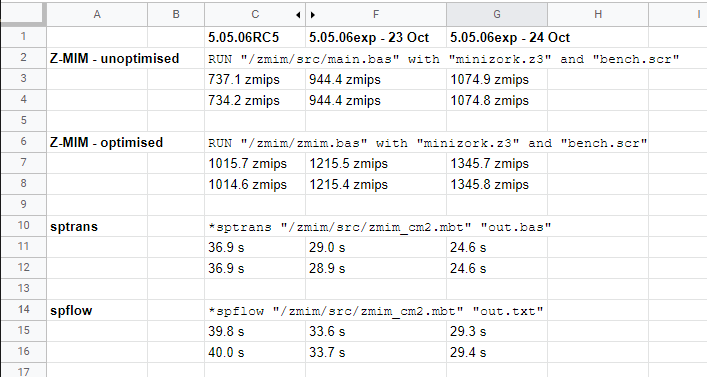

One final tweak - function lookup is now hashed and the maximum number of functions increased to 512. Gives me another 5% or more improvement on most tests

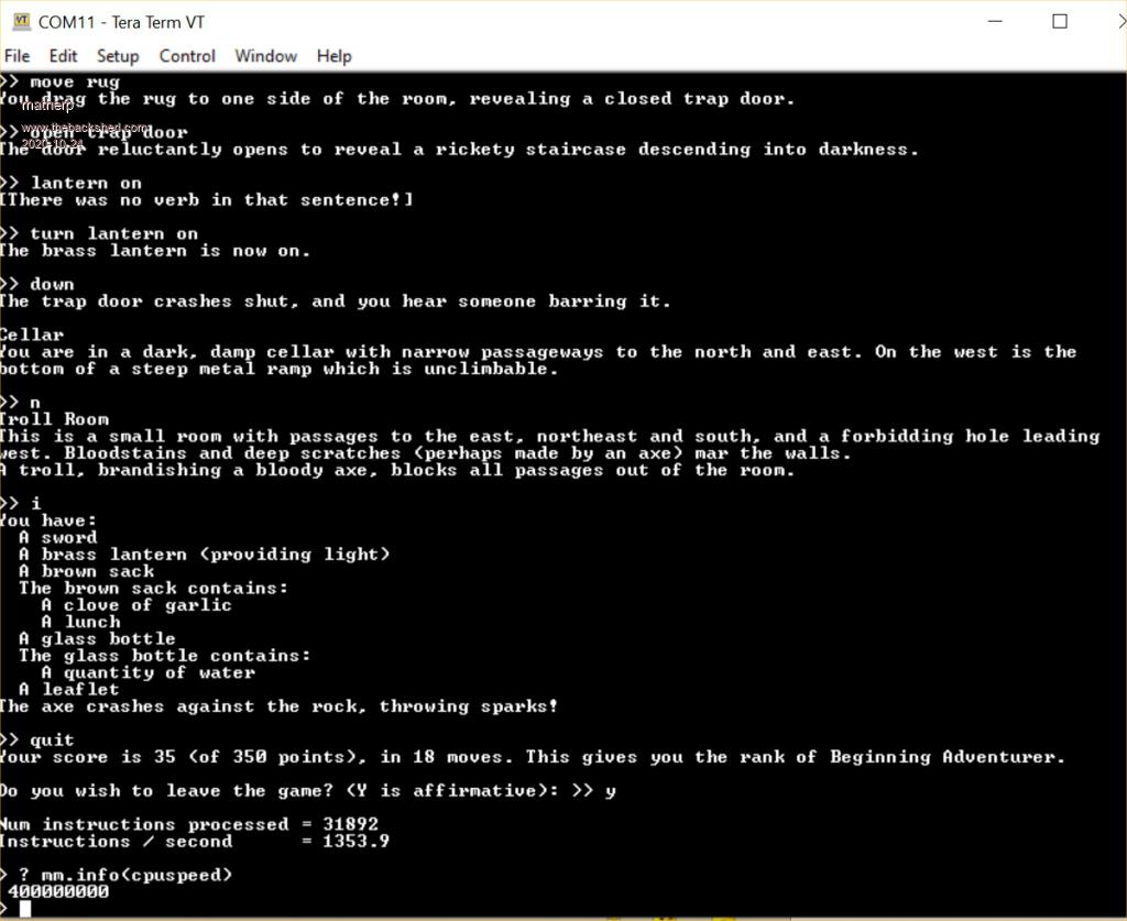

Very impressive, the unoptimised version of Z-MIM now reaches 1000 zmips.
