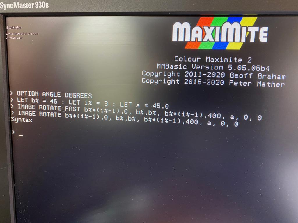

Here's a weird one, using 5.05.06b4:
OPTION ANGLE DEGREES
LET b% = 46 : LET I% = 3 : LET a = 45.0
IMAGE ROTATE_FAST b%*(I%-1),0, b%,b%, b%*(I%-1),400, a, 0, 0
The above behaves as expected.  However, if I run:
IMAGE ROTATE b%*(I%-1),0, b%,b%, b%*(I%-1),400, a, 0, 0
I get the error: "Syntax".
I can't figure out what I am doing wrong - I thought that IMAGE ROTATE and IMAGE ROTATE_FAST should be exactly the same except for the keyword.
I've attached a screenshot, starting from a power-on, as verification.
Posted: 05:02pm 17 Sep 2020
  Quote  I thought that IMAGE ROTATE and IMAGE ROTATE_FAST should be exactly the same except for the keyword.
Thanks for the post. It is a documentation error. Neither IMAGE ROTATE non IMAGE RESIZE have the optional flag because as they use bi-linear interpolation it makes no sense. We will update the manual in the next release to reflect this
