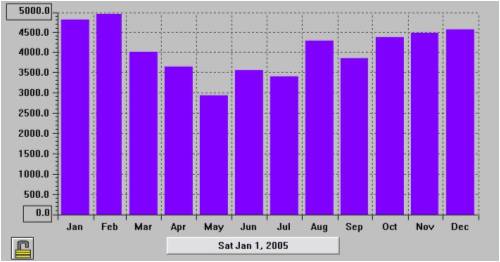

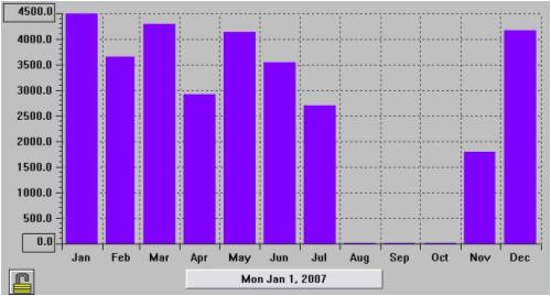

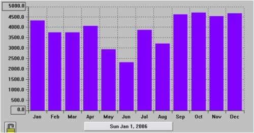

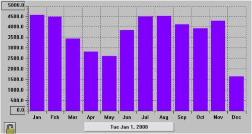

I think it may be interesting to show some recorded wind data from where my mills are situated. These are on the southern Fleurieu Peninsula, near Victor Harbor in South Australia. I would rate my wind site as OK. There are 4years of data, in some graphs. The data is Wind Run. This is an accumulated amount of the total wind that has passed a point in the timing period measured in kilometers.
There is some lost data in 2007 when the recording computer died. The logged data is at 10 minute intervals from averages taken from a 1 second update rate.
The wind is well proportioned during the year. There is no time without some wind. There is less wind during the winter months, that may seem odd.
I recorded the weather data for 12 months before deciding a windmill would be viable for useful power generation and not just an ornament.
I would recommend some data collection at the selected wind site prior to building or installing a windmill. I have seen some windmills that are ornaments, that have been paid for with tax payer dollars.
Gordon.

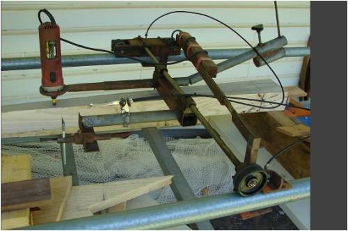

Posted: 09:10am 20 Dec 2008
Hi kiwijohn,
here is a photo of the business part of the copy machine. The main rails are shown, and the travelling router with stylus and counter balance.
This is a 1hp, 37000rpm router.
I have to set up the original with blank. The posts [far right] are for precise alignments.
Gordon.

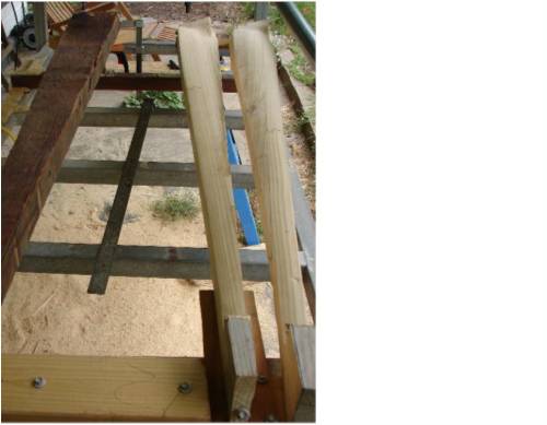

Posted: 04:03am 24 Dec 2008
I have just finished the rough cutting for a new blade master. I have made 2 templates, one for each side of the blade. This has resulted in a much stronger template. The templates should not be able to flex in any way. I will post some pics when I sand them a bit. These are a tapered twist, with undercamber and thin airfoil section.
The final blade will end up around 1.35m, with a flat mounting surface.
I have a few options with cutting blades. One at a time or all of one side, and then all of the other. I haven't decide which way to go yet. The blade will be cut from a blank longer than need be, so alignment as the plank is turned over should not be much of a problem. The blades will not take much time to rough cut. I should end up with close to identical blades.
Gordon.

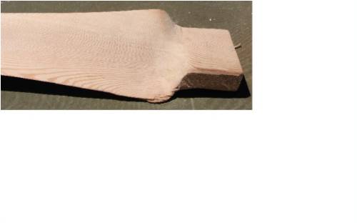

Posted: 04:56am 26 Dec 2008
hi feix,
I have made a test profile from the two templates.
here is a pic, of the business end.
The machine is not CNC. I would imagine this type of application would challenge any programmer. I have found that the rough process would be difficult with CNC. I have made jigs for each half, to aid the alignments of the two halves. I went 0.5mm too thin, so this will be adddressed in the next blade.
I use an older cutter for the roughing. This is changed to a new one for the last pass. A light sand, and the blade is done. The flat mounting surface worked out well.
The blade has taken a bit more time than I hoped. The weight has come in at 690g. This will go up a bit with sealing and painting. This is less than the 1kg that I had estimated. The blade has come out at 1.35m long, so this will make a rotor of 2.9m dia, once bolted to the rotor hub.
I am hoping that the blade design will give a higher rpm, so I may have to use the series 80 rewire. This may increase the power to the magical 1kW, if the rpm increases from the 440rpm to above 500.
The blades on the machine are currently 1.9kg each. The mill should be more responsive with the new blades.
I have no plans to publish instructions to make the copy machine. The basic design is similar to the operation of a lathe, but without screw controls. If you see how a lathe is constructed, this is a start. The key is rigidity, and light weight in operation. Counterbalancing and linear bearings and large self aligning rollers achieve these goals.
You should only use one rail in each dimension that has precise alignment.
Gordon.
