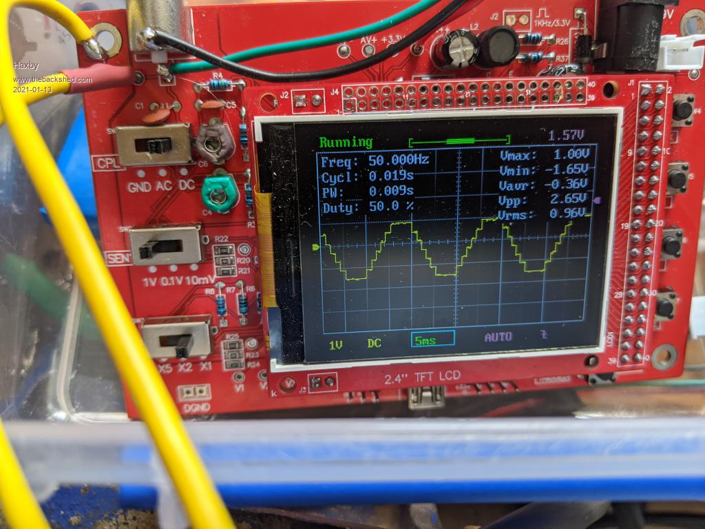

Could the toroid cores have become permanently magnetised?
Here was the working trace with 2 inverters, no load, 140vdc. I can see an offset from zero. Is that a clue?...

In the last test, I still had 5 ohms in series with each of the two transformers. I would have thought that would be enough to save the IGBTs...
Posted: 03:28am 13 Jan 2021
Ah yes, that inverse diode is extremely important.
That last waveform looks o/k.
Don't worry about the ragged looking steps, they always look like that until you have all four inverters going.
The reason being, that the transformers are trying to switch a current that is stepping up and down.  Inductive components don't like instantly changing current.
When all four inverters are running, the current in all of the transformers will be a nice smoothly changing sine wave.
All four transformers will be very happy, and all the waveforms look a lot cleaner and much nicer.  Its an amazing transformation.

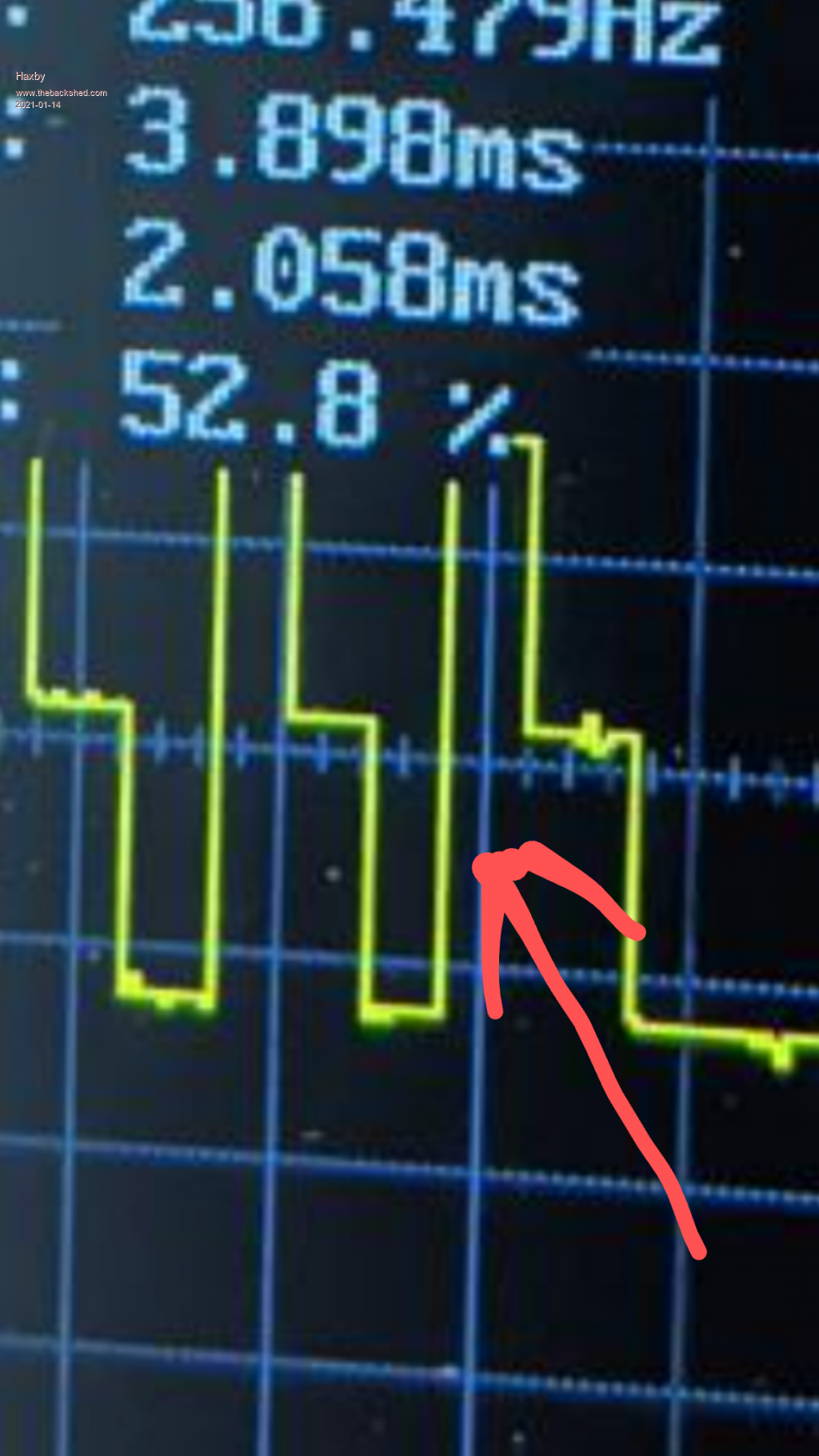

Since both the large and medium inverters work well at lower voltages, but since only the medium inverter is blowing up at high voltages, my suspicion is that the culprit may lie in the fast transition from bottom peak to top peak of the rapidly changing voltage illustrated here:
I haven't ruled out the dead time as I don't have a 2 channel scope, but what might be more plausible is that a snubber circuit may be needed to keep this large voltage transition under control.
Any thoughts on this theory?
Posted: 06:17am 14 Jan 2021
Each side of the H bridge switches completely independently, and is clamped between ground and dc supply by the inverse diodes.
As you have noted, the largest inverter only ever switches one side at a time, whereas the other half bridges sometimes switch simultaneously in opposite directions to go from full peak voltage one way, to full peak voltage the other way across the primary.
I cannot see how that could be harmful, but obviously "something" is still not quite right somewhere. Klaus is still having mysterious random blowups as well, and we have not figured that out either. He is running mosfets at 48v, so his situation is a little different.
