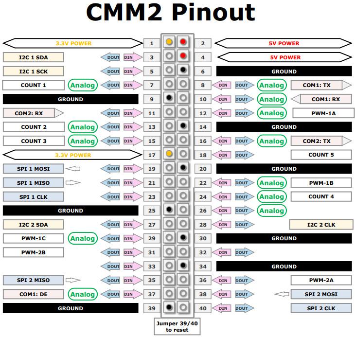

Might I suggest improvements to the schematic:
1. Adding signal names/desc (with MMBasic Pin #s) to CON4 I/O connector (the 40-pin) as well as indicating 5V tolerant pins (maybe with a *)
2. Schematic should have max recommended current draw for 3.3v (somewhere near CON4)
3. 5V warning about no fuse on the 5V supply with a note to be careful about short circuits/overcurrent.

CircuitGizmos
Joined: 08/09/2011
Posts: 1427
Posted: 07:55pm 05 May 2020
CMM2 pinout:

@ flasherror: As a member of the group who helped to develop the CMM2, let me just say that none of what you suggest at a hardware level in your posts for changes will EVER be implemented in this release.  This is what the CMM2 is - take it or leave it.
While I can certainly appreciate your suggestions are in good faith, we are not going to change the design now - that simply won't happen, so any suggestions along those lines will not be entertained, sorry.
No offence.
As you yourself elude to, perhaps in a future CMM2+ release, some of what you suggest could be taken under advisement, but NOT for this release.
Just for your and the rest of the member's information, most of what you have already suggested(extra I/O, CLICK module sockets etc, etc), was discussed in detail internally within the group when the CMM2 was being developed, and for various reasons, those ideas were simply not going to be possible.  Mainly cos of lack of real-estate on the 2-layer PCB.  You COULD go to four-layer, but that was something we were never prepared to do, cos 4-layer PCB's of that size are considerably more expensive to have made then 2-layer ones are, and that would have simply made the project unattractive economically to users or potential buyers.
