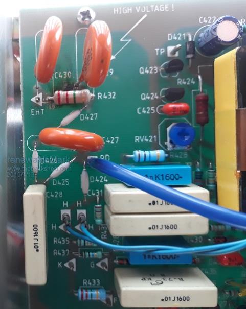

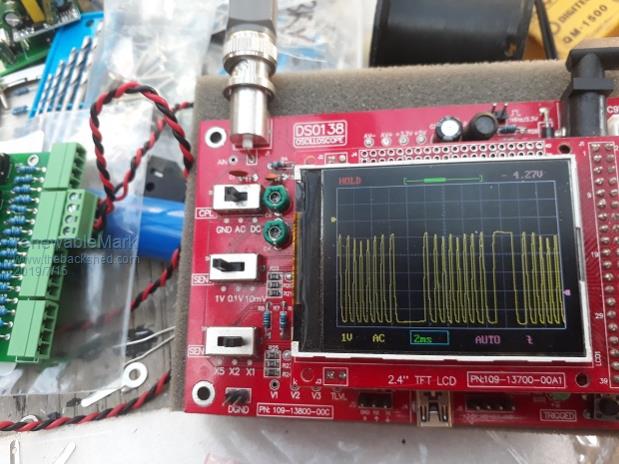

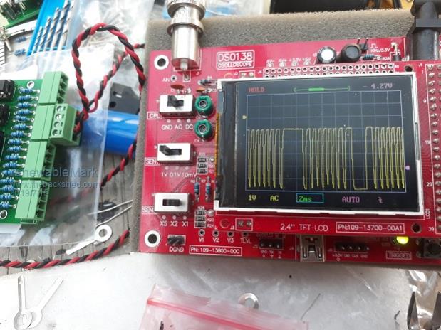

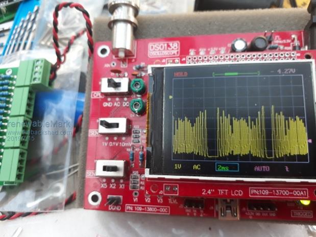

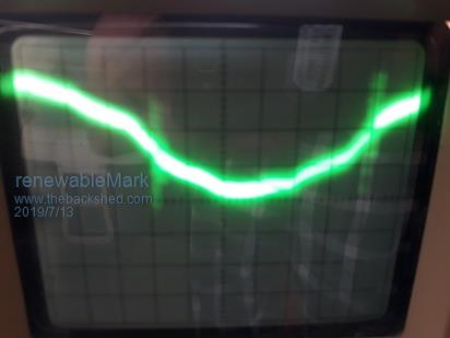

It did bring back the trace to the full screen, but it's wavy with spikes in it.
So something else is stuffed.
Probably that D427 which is a BY409 diode.
But hell, where could it finish, could be chasing my tail for weeks and end up with the same busted bit of 30 Y/O crap.Edited by renewableMark 2019-07-14
Cheers Caveman Mark
Off grid eastern Melb
Posted: 07:08am 13 Jul 2019
Very difficult to tell from a photograph what that really looks like.

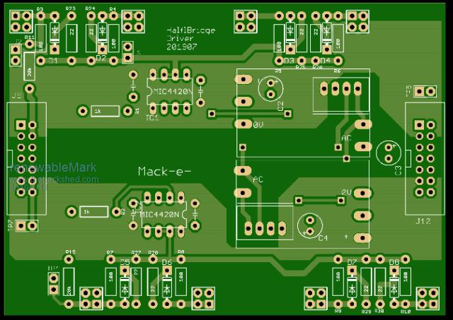

OK got a bit distracted with the busted CRO, back to the inverter.

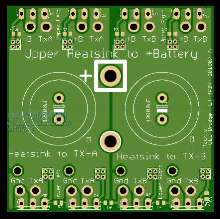

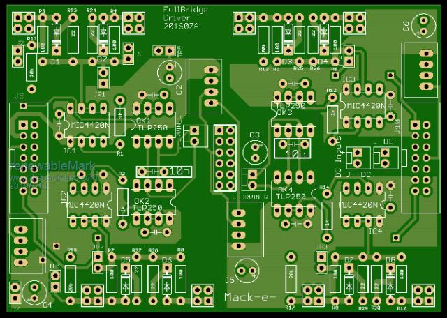

I decided to go with Mack's design of boards, took me a while to understand how it all goes together.

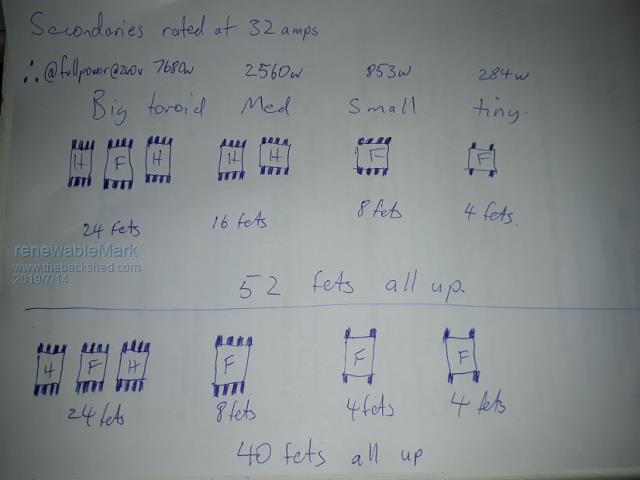

So I have two options of how many power boards to do
Option 1
Big toroid uses 3 power boards with one full bridge driver and 2 half drivers, 24 fets
Med toroid uses 2 power boards with 2 half driver boards,16 fets
Small torroid uses one power board with 1 full driver board, 8 fets
Tiny toroid uses 1 power board with 1 full driver board, 4 fets
Option 2
Med torroid uses one power board with 1 full driver board, 8 fets
Small torroid uses one power board with 1 full driver board, 4 fets
I'm thinking my usual peak doesn't get over 5Kw so option 2 will do just fine.
These are Mack's boards he has kindly shared with us all.
So the idea is to mount all this on some fibreglass channel vertically so natural cooling will help.
That will hopefully fit in a school locker I have and will also have a nice small footprint.
Cheers Caveman Mark

mackoffgrid
Joined: 13/03/2017
Posts: 460
Posted: 07:30am 14 Jul 2019
Your option 2 is exactly what I have done with the 26v inverter. The power of the medium transformer is 33% of the large Transformer so the loading is shared pretty well. So it is fitting the second transformer is serviced by 8 mosfets when the large transformer is serviced by 24.

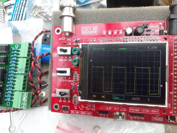

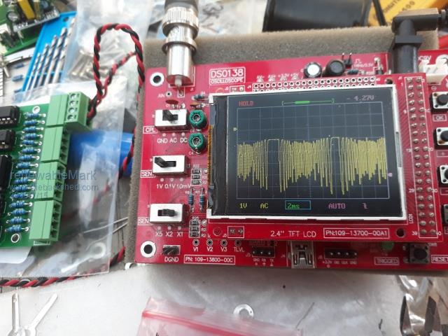

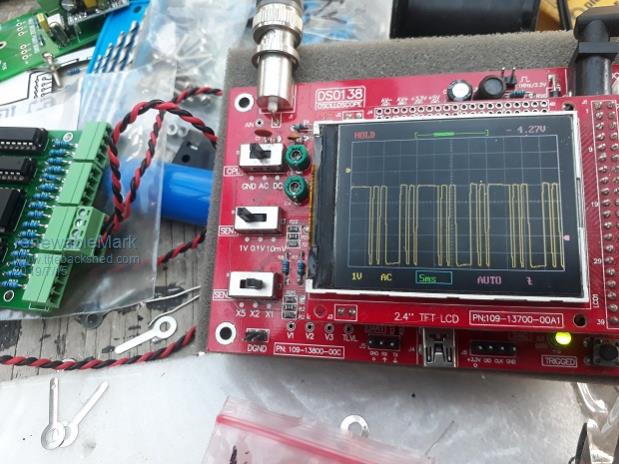

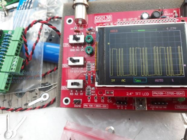

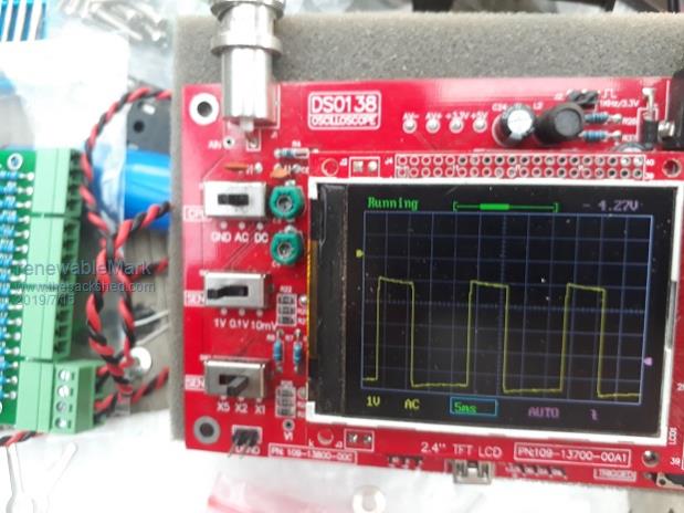

Here are the drive signals
They all look OK to me.

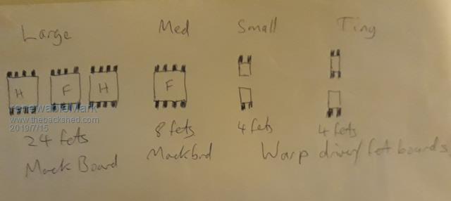

Since I have the small Warp driver/fet boards made I was thinking they could still be used for the two small torroids and with the big torroids the Mack boards could be used.
Like this
Edited by renewableMark 2019-07-16
Cheers Caveman Mark
Posted: 08:53am 15 Jul 2019
Those waveforms all look perfect Mark.
Four of those small half bridge boards work just fine in my own two smaller inverters.
It only starts to become a bit more complicated when you need to run multiple mosfets in each leg.

I was thinking more of the compatibility of the Mack driver boards and the Warp ones used in one unit.
On your Warp unit you have 8 identical driver boards.
4 drive small fets.
4 drive the IGBT's
What I propose to do is
Warp control board driving
4 Warpdriver/fet boards
& 4 Mack driver/power boards.
Will all the timing of the two different driver boards still work out?
If I use the same dead timing cap they should match ok yeah?Edited by renewableMark 2019-07-17
Cheers Caveman Mark
Posted: 09:47am 16 Jul 2019
Its all compatible and all completely plug in interchangeable.
No timing problems, its all very low frequency switching.
Also Tinkers boards would work too.
All use the exact same opto driver interface and plug pin connections so its plug and play.
Andrew and I arranged it that way deliberately right from the beginning.
Only thing that may need a bit of thought is the power supply to the isolated gate drivers.
I take my power from directly across the dc supply to each bridge. That worked for me because my inverter is 100v.
Some of those small postage stamp supplies will not start up and run reliably from a 48v battery that is very low, but others might be o/k. There seems to be a big variation depending where you buy those supplies.
Both Klaus and Andrew have used a different way to power their boards, but otherwise they are completely compatible.
Dead time is not critical 1nF to 10nF would cover the range (300nS to 2.5uS).
Something about in the middle of that should work fine, say 2.2nF or 3.3nF for mosfets.
Its only the big old and slow IGBTs that need 2.5uS.
