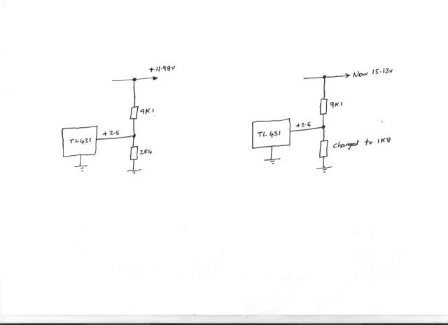

Now the HCPL3120 has an internal undervoltage lockout that needs to reach 11.5v nominal.
Using the 12v supplies as is, might be a bit dodgy, 15v supply is preferred anyway for mosfet and IGBT gates.
I ran out of the original 15v supplies, so what I have found to be a good solution is to modify 12v supplies to provide 15 volts by changing one of the feedback resistors from 2K4 to 1K8. This works fine, because the supplies are very lightly loaded.
A 12v 450mA rated supply only needs to provide gate drive power which is negligible at 50 Hz !

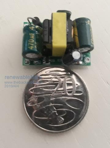

Poida, you'll find that one has a bigger footprint, no big deal unless you wanted it for Warps driver boards.
The little ones are this big
I asked these people if they can do a 15v version.

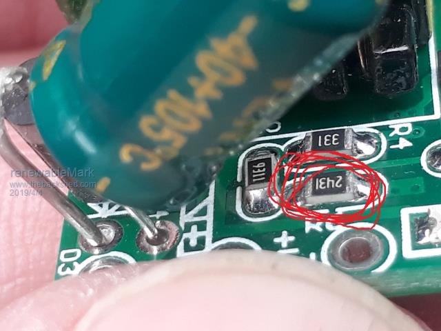

Apart from that is it R6 you change Warp?
Cannot say for sure Mark.
These little boards fit into standard plastic housings so they are the same outside physical size guaranteed.
The pcb pads for input and output are "usually" in the exact same place but not always.
But there appear to be Multiple Chinese manufacturers making these things. Some have component designators, and some do not. And those that do may not be the exact same, so beware.
The circuit component values are all pretty much standard, and there is a voltage divider connected directly across the dc output pins which consists of a 9K1 and 2K4 on the 12v devices.
If the 2K4 is replaced with a 1K8 the output voltage increases to typically 15.1v.
Altronics have the 1K8 surface mount resistors in packs of five.
