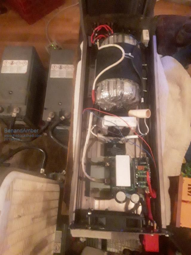

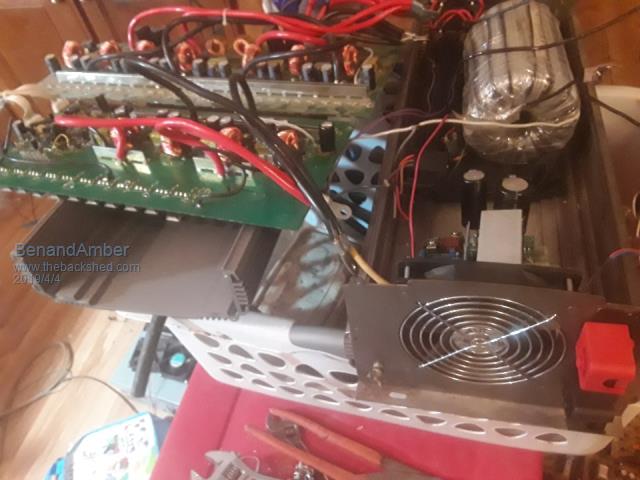

we found a nice case for our little inverter
notice we put some big caps in
Had to drill through the board and put 14 gauge wire up through works great
The donor is a 12 volt inverter we used in the RV to run a air conditioner
I was always impressed with this inverter it ran anything I plugged into it
Worked fine when I took it apart
But it had to go to make room or the low frequency
Have you guys ever seen a inverter like that with all the little toroids instead of square Transformers

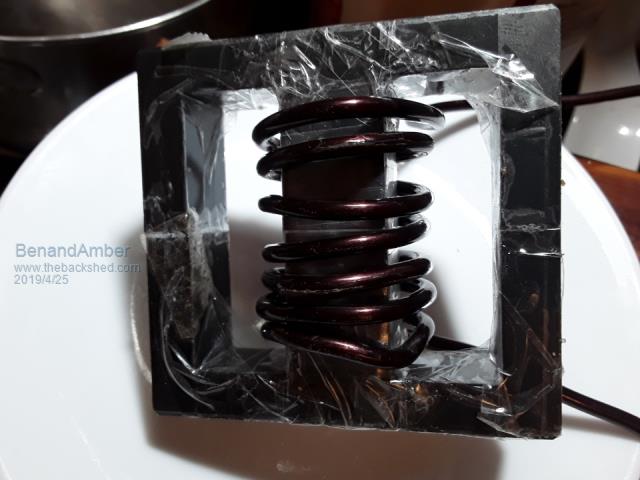

It is white and it is in the very center it has quarter inch rubber underneath of it and the white is made out of flexible water pipe split open and cupped around the e80 core
Pretty poor excuse for a choke if you want to go off your work and a lot of the other excellent awesome people on here but I'm just a newbie and very poor so poor people have four ways
By the way it came with no Gap and I made the center Gap myself
so that could have something to do with how loud it is it is glued together on the outside legs
Hey if this core was three times as loud I would still be really impressed
I would encourage anyone else that wants a really powerful inverter cheap to follow what poida the great wrote to me earlier in this post
Thank you for taking the time to read my post and be interested in itEdited by BenandAmber 2019-04-26

If you look towards the bottom of this page you can see how to clamp them so they don't squeal.
Otherwise you can superglue them (with the spacers)
Be very careful if clamping, ferrite is incredibly brittle and will crack if you just look at it the wrong way.
Glue is safer but it's permanent, no changes easily then.Edited by renewableMark 2019-04-26

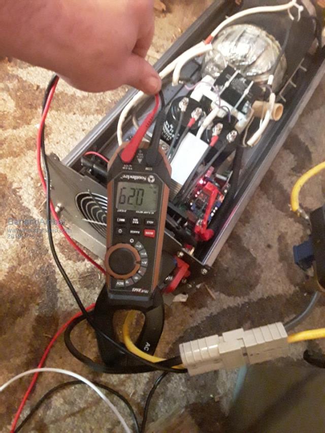

Mine doesn't get any louder with load just constant humming and the two outer legs are super glued together the center has a gap

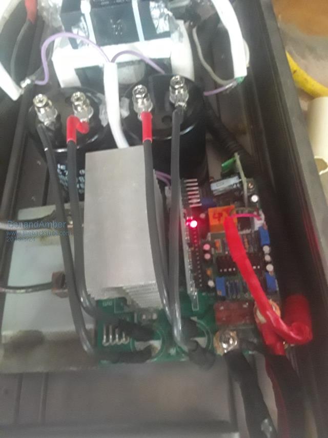

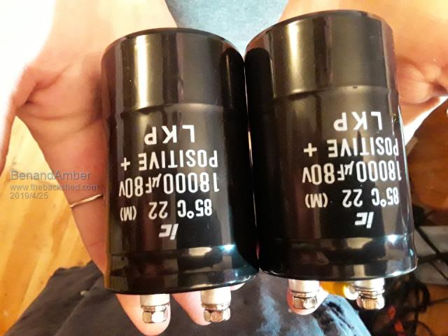

the capacitors I ordered for this little tiny inverter came in and I put them in this evening
I'm happy with that idle current that big case fan is running constantly never goes off

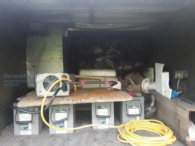

I put the top on it testing over off to the RV to run all the power tools and a small air conditioner
Just to remind everyone it has four mosfets that's itEdited by BenandAmber 2019-04-26

Posted: 12:56am 09 May 2019
By the way the humming of the choke isn't bad at all with the lid on it
I mean if you was using it for a pillow it might bother you but other than that it's great
Still use it everyday at the RV under construction circle saw jigsaw sawzalls air conditioner and lights

A few observations: the winding needs to be physically *very* tight around the center core and locked in the winding space. 3 turns of welding cable of the right diameter does that automatically.
If you want to wind them like you saw in my pictures, I do that on a lathe, can't be done by hand winding.
Your idea of removing part of the center leg to create an air gap was short sighted. Yes, it does create a gap but it also weakens that part so you can no longer apply sufficient clamping pressure to stop the buzzing noise.
It would be much more clever to place a non metallic shim (strong card board, plastic, etc) between *all* three legs. No removing of any ferrite. This *must* be of exactly the same thickness at all legs or clamping pressure will crack the ferrite. The total 'gap' is now twice the thickness of one shim.
You do that 'air' gap to increase the saturation level but without saturation testing gear its a stab in the dark and probably not worth the trouble.
I ran a E65 ferrite choke for a long time in my first inverter, a power jack 8Kw module. That only had thin mylar tape (~0.1mm) between each leg. It reduced the humming and the inverter worked fine.
In case you are wondering where the buzzing noise comes from, the very powerful alternating magnetic field in the core tries to move the wires and the core halves. If loose, they will get noisy.

And another observation on the picture above. I see you replaced the capacitors. Why do you think the original ones were soldered on the PCB?
They were to make the shortest path for the heavy currents from the caps to the mosfets.
Placing the caps on the opposite of the board and connecting them with long smallish wire just about negates what you tried to do.
Place the bigger caps next to where the were originally located and connect them with tinned copper strips to the board, that is easier than making short big wire links with lugs on the end.

and maybe move those capacitors I have them on I think 10 gauge solid wire
I drilled down through the board and they are soldered onto the DC railsEdited by BenandAmber 2019-05-29

I would leave the original electro's on the pcb, if you want to add extra capacity as you have done - which is ok, then mount the extras closer to the pcb and wire to the underside of the pcb to the original electro terminals (thick copper braid works well for this).
The pcb mounted ones should not be removed as they present a very low esr impedance with low connecting wire inductance. By removing them and placing at the end of long wires the circuit inductance will prevent them doing their job properly.
