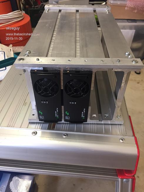

I also made up a framework (pic below) for 3 Eltek Flatpack2's but only have 2 on hand at the moment so 4 KW is my maximum throughput for now. It powers my inverter to drive my compressor and drop saw with ease.

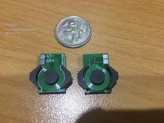

I also got back the little RM6 transformer PCB's with track windings and it works a treat. The Freq has to be upped to ~ 350kHz for the reduced turns to avoid saturation but it sure beats winding enamelled wires etc.  Isolated FET gate drive power supplies are a cinch now. For a 12V in supply the gate drives are all ~ 12.5 - 13V under normal load.

BenandAmber
Joined: 16/02/2019
Posts: 961
Posted: 06:33pm 30 Nov 2019
The top picture is really cool the bottom picture blows my mind
WOW!!!
